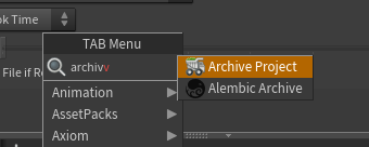

Anywho I checked your file, but unfortunately there were no textures included and there were some missing HDAs so I wasn't able to reproduce any crash.
You can use the "Archive Object" tool from the obj tab menu to create a shareable file setup that includes all references.
Screenshot 2026-06-18 175101.png (12.05 KiB) Viewed 347 times
Or tools like odtools also have some features that can do this - but the above tool is included with Houdini.

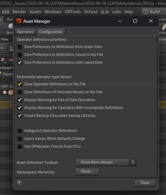

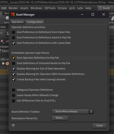

And if to make sure any HDAs are included you can enable this setting in the asset manager:
