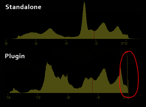

Unfortunately it did not, I still get the same cutoff at the end of the SDR range as before. Do you get the same result using my test files? I would not want to rule out a rhino settings issue yet.
In PS I open the EXR and press ctrl+alt+a to open the camera RAW editor. Top right It then shows the curves I put in the last post. I got EXR-iO installed though, that might change PS behavior somewhat. Though I'm sure its got nothing to do with my issue since it works with the Standalone output.

I downloaded your EXRs, put them in viewer.openHDR too, and compared them. They have the same issue mine had.
What's concerning is this spike. It indicates that, while the file is technically HDR 32bit, it only really uses the SDR space, and clips values that go beyond SDR White to what would be 255/255/255 in SDR, thus losing the benefit HDR offers in the first place.
Given that you get the same results, I believe this to be a bug in the plugin :/

I applied those settings and got this result:
the Standalone still seems to generate HDR Data, so this might not be it, but certainly worth a shot
