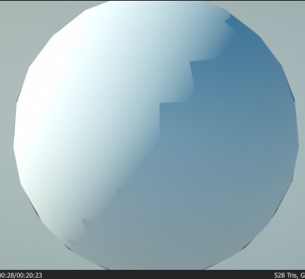

I tried exporting a sphere from modeler, checking the .obj it did write the normals. In octane I end up with this:
(smoothing is turned on in material)
haven't exported .obj from modeler to octane before, what settings are you using?
GTX260 Seven 64bit
I'm Superfrog

holocube
Posts: 73
Joined: Sat May 29, 2010 8:45 am
Location: London
Actually I got the same render with Francks sphere.

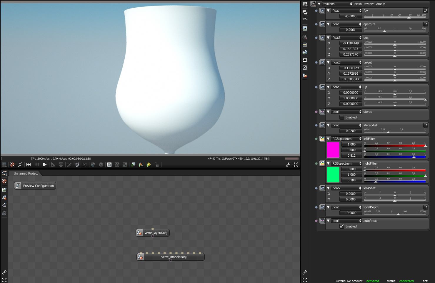

Ok,
I have just tryed with an old scene :
The first is from modeler, the second from layout. lw 10.1 with octane 2.52

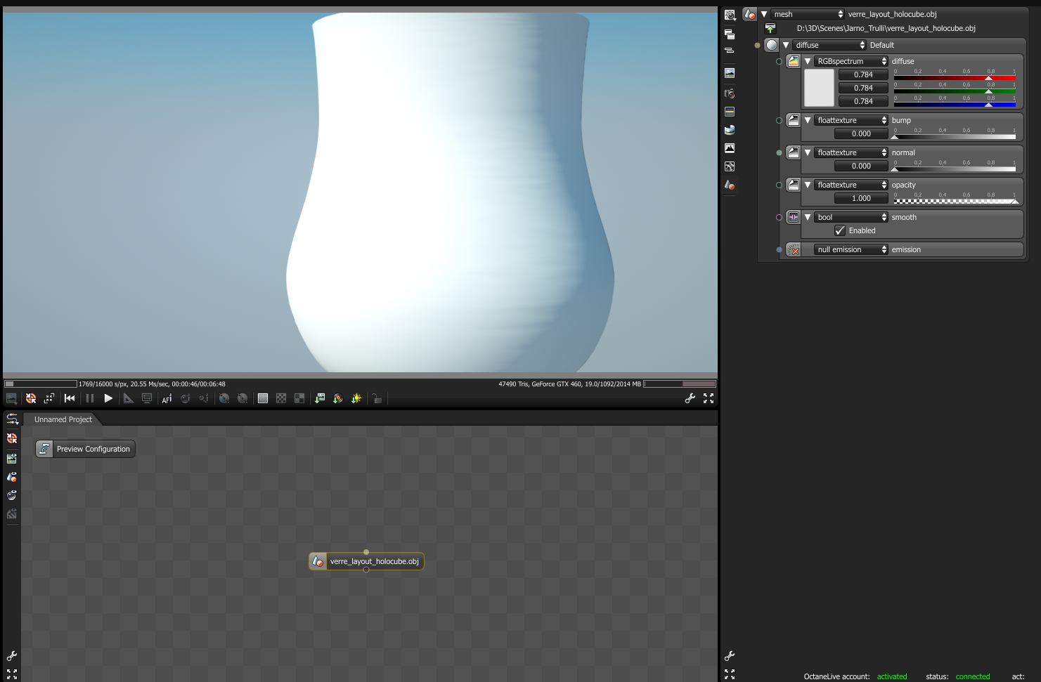

could you try attached .p. x64
set export options to:
export proporties: normal
write point normal: off
plugin.zip
(229.91 KiB) Downloaded 298 times

scratch33
Posts: 224
Joined: Sat May 29, 2010 7:45 am
Location: Bienne(Switzerland)
Not bad... ;)
I can now switch on/off the smooth option in octane and there is a difference between the two. But they still are strange artefacts on the surface
Here are the result picture:
1) from modeler
2) from your new plugin

holocube wrote:I tried exporting a sphere from modeler, checking the .obj it did write the normals. In octane I end up with this:
Exact this image isn´t a export issue, this is a problem with the renderalgorithm, called "Terminator".
http://refractivesoftware.com/forum/vie ... tor#p49173
