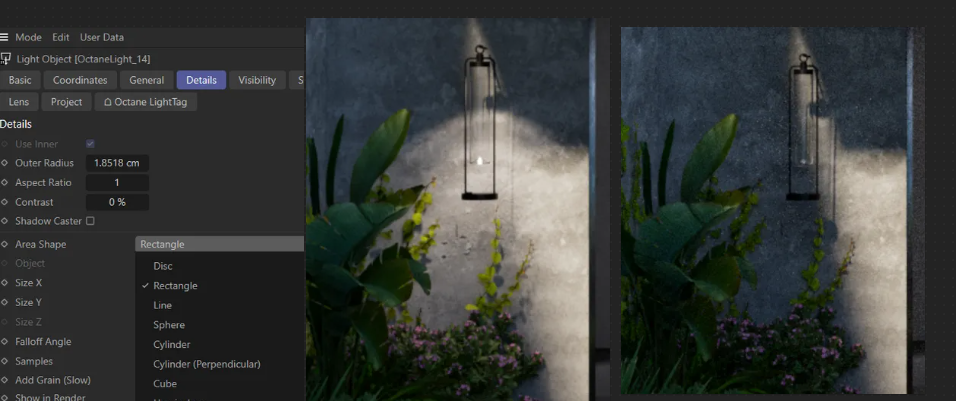

Hi
I notice ies light won't work if the light Area Shape is set as a Disk. only works as Rectangle in this version.
https://app.milanote.com/media/p/images ... Xo1xIRGA4e

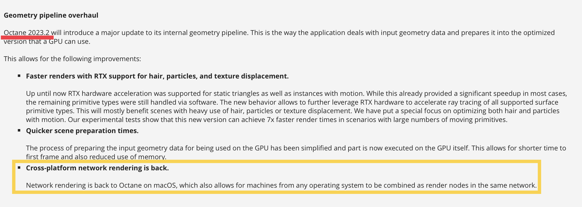

Does anyone know if 2023.1 has netrender (Mac/PC) back yet????
They've been saying all year "yeah in 2023 probably" but there's no real yes/no in the 2023.1 post. Is it? When? I mean, if it's not in this one, could they at least say "hey sorry it's not but coming soon". And if it is, could they say "hey it is"? Instead there's nothing, like if they pretend it's not a thing, we'll forget about it or something...
Alex
Hi Alex,
we have already talked about this several times, multi platform Net rendering is planned for the next major update, after 2023.1:
Most likely, 2023.2 version will be named 2024.1, so "hey sorry it's not but coming soon" ;)
ciao,
Beppe
