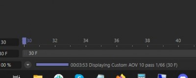

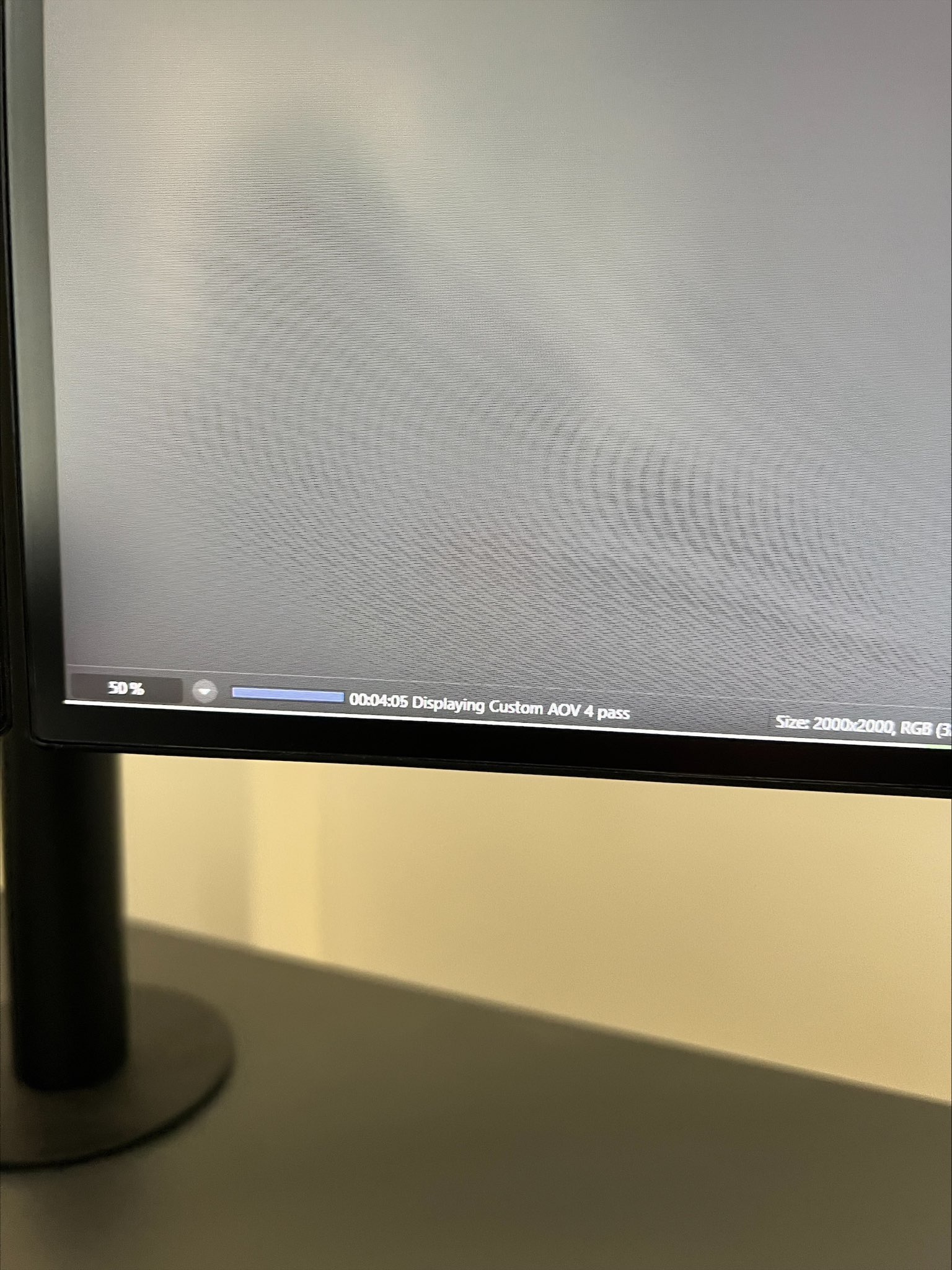

We seem to be getting an inconsitent issue with octane finishing renders since updating to the latest version of cinema 4d (2023.2.0).
Ive attatched a photo, it seems to be freezing octane completely when it tries to save the frame if the AOV's are enabled.
It sticks on displaying Custom AOV pass, this could be any of the AOV's it seems to fairly random.
This will happen on certain files then suddenly fix itself to then return again.
We tried downgrading to R1 also the previous stable R10 but it still has the same issue which would suggest a compatabilty issue with the new cinema.

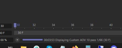

Hi Aoktar,
Thanks for the quick reply on this, I managed to get the crash conistant one of our files then installed R8 but unfortunately the issue still remains.
Screenshot 2023-04-05 122738.jpg (14.26 KiB) Viewed 4228 times

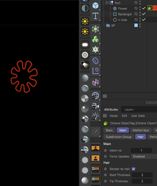

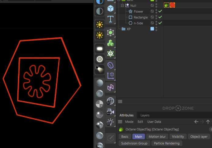

I have a question, why can't we render a spline with an octane object tag, when the spline is a primitive (non editable) ?
Toche
Posts: 25
Joined: Mon Aug 15, 2022 2:24 pm
FxDesign wrote: I have a question, why can't we render a spline with an octane object tag, when the spline is a primitive (non editable) ?
Hello,
It seems working fine for me... Have you tick "Render as hair"?
Then you can drag it to a Null even if you don't have the Hair tab anymore.
