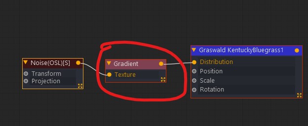

Crash while removing node connected between Noise and Scatter. Also why this configuration completely doesn't work ?
Can we have working world space projection in C4D CPU noises in Scatter ? At the moment it works only on object/UV space so if we have great looking Scatter preset for grass for example it looks totally different using it on different objects size.

SSmolak wrote:Crash while removing node connected between Noise and Scatter. Also why this configuration completely doesn't work ?
1-OSL is GPU based and it will not work with Scatter object. It can only use the CPU shaders.
2-We can't because of performance issues and design of it.

aoktar wrote: 2-We can't because of performance issues and design of it.
and how about sliders for different effectors in Scatter like it is in C4D Cloner ? It would help layering different Scatters within one objects using only the same effectors.
Architectural Visualizations http://www.archviz-4d.studio
Posts: 16067
Location: Türkiye
probably possible if GUI gives me the control
