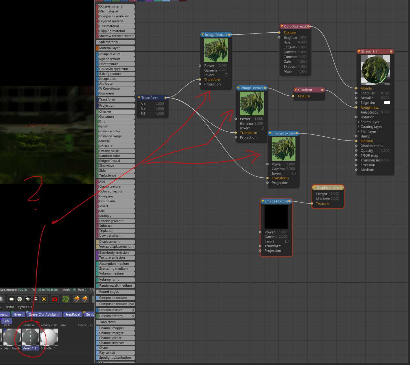

This is strange!
After installing 2021.1.6-(R2) whatever project I load all my textures got changed.
F.e. a wood texture has in all image-texture-slots (Albedo, Spec, Normal etc.) suddenly a total different
image (a normal-map from a different plastic material) loaded.
Even the texture in my HDRI Env has this material loaded.
Any idear???
thanks Mike
Any idear???
thanks Mike

Hi Ahmet,
went back to R1 yesterday and today installed R2 again.
Same like yesterday. All materials changed the texture.
Please see screen for example.
All the ca. 50 materials in this scene now got this tree-texture applied even
material preview still showing the correct texture.
And this texture-change happens to all my other jobs/projects but with
another texturemap applied to all materials.
Again wneed to go back to R1
regards
Mike
regards
Mike
