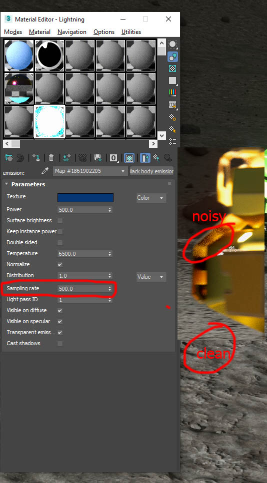

Can we please get AUTO sampling rate for lights. So if my light sampling ratio is not correct and some lights have noise the system automatically adds more sampling rate values.
I think sampling rate is wrong. Having hundreds of lights in the scene, checking why some are noiser than others, creating balance between them is a pain. The system should see noise and auto adjust sampling rates to noisier lights

coilbook wrote:Can we please get AUTO sampling rate for lights. So if my light sampling ratio is not correct and some lights have noise the system automatically adds more sampling rate values.
Have you tried enabling kernel > AI light, then setting all your light's sampling rate back to a default of 1.0?
I'll try. I thought AI was an additional feature and usually it increases render time a lot like a denoiser.

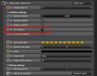

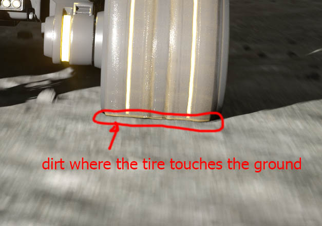

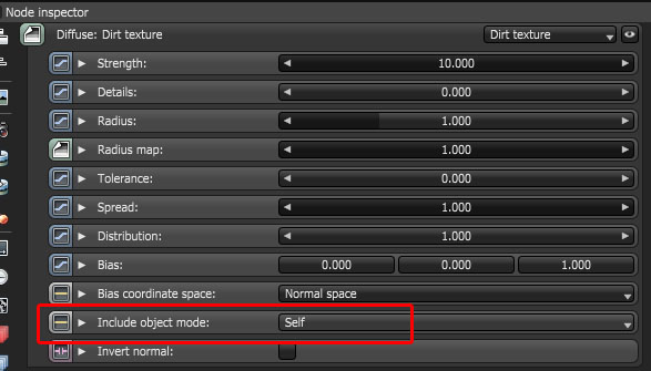

Another problem that was never solved (Chaos solved it) Please lock dirt to a single mesh or make mesh that touches the dirt mesh not leave a dirt mark (exclude from leaving a dirt mark)

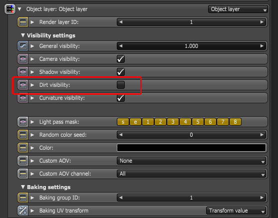

coilbook wrote:Another problem that was never solved (Chaos solved it) Please lock dirt to a single mesh or make mesh that touches the dirt mesh not leave a dirt mark (exclude from leaving a dirt mark)
If I'm understanding you correctly, you can already do this. In the dirt node, set the "include object mode" to "Self".
You can also ignore entire objects, by disabling the object layer > dirt visibility.
