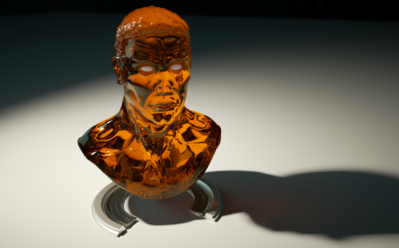

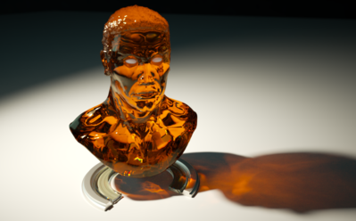

Hi Guys,
I've noticed a caustics problem with 2.50 and 2.51. I have provided the examples below.
The 'test head' scenes are identical between 2.49b and 2.50. Any ideas of whats going on?
Intel Core i7 CPU 6850K @ 3.60GHz 128.0 GB Ram / Win 10 64 bit / 1x GeForce RTX 3080
roeland
Posts: 1826
Yes, 2.50 and 2.51 contain a bug in PMC, preventing it from rendering caustics properly. This will be fixed soon.
