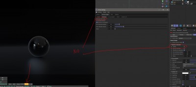

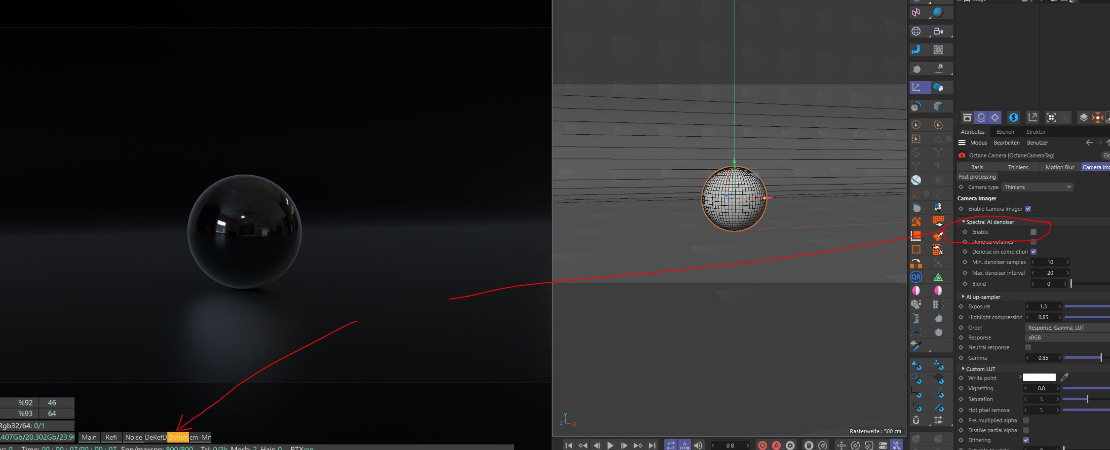

My strange behavior with denoised passes is still there. But its a bit complicated:
- when I first add only denoised AOVs and have the denoiser in the camera tab off = no denoised passes
- when I then turn on denoiser in cam tab = all denoised passes are there
- when I turn the denoiser in cam tab off again = no denoised passes again
- when I turn the denoiser in cam tab off again, but add the non-denoised AOVs = all denoised passes are there again (even if denoiser turn off in cam tab)
But thats no more a big issue ! I just should not forget to turn on the denoiser in cam tab before hitting the render button! :?
Mike

Miohn,
you cannot get denoised passes without activating the denoising from Camera Imager.

aoktar wrote:Miohn,
maybe you not! But I can! :P :D
regards

More than likely, you have the Denoiser enabled In Octane Settings > Camera Imager > Denoiser tab > Enable Denoising.

jayroth2020 wrote:More than likely, you have the Denoiser enabled In Octane Settings > Camera Imager > Denoiser tab > Enable Denoising.
no :D
