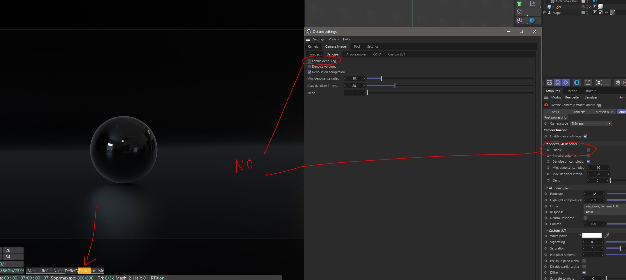

My strange behavior with denoised passes is still there. But its a bit complicated:
- when I first add only denoised AOVs and have the denoiser in the camera tab off = no denoised passes
- when I then turn on denoiser in cam tab = all denoised passes are there
- when I turn the denoiser in cam tab off again = no denoised passes again
- when I turn the denoiser in cam tab off again, but add the non-denoised AOVs = all denoised passes are there again (even if denoiser turn off in cam tab)
But thats no more a big issue ! I just should not forget to turn on the denoiser in cam tab before hitting the render button!

Miohn,
you cannot get denoised passes without activating the denoising from Camera Imager.

More than likely, you have the Denoiser enabled In Octane Settings > Camera Imager > Denoiser tab > Enable Denoising.
