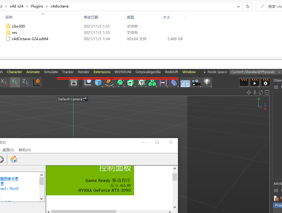

1.In S24, the plug-in is not displayed after installation
Posts: 10610
blackcat321 wrote:1.In S24, the plug-in is not displayed after installation
Please make sure to have updated S24 to R24.111 build, as reported in the first post in red, or plugin cannot be loaded.

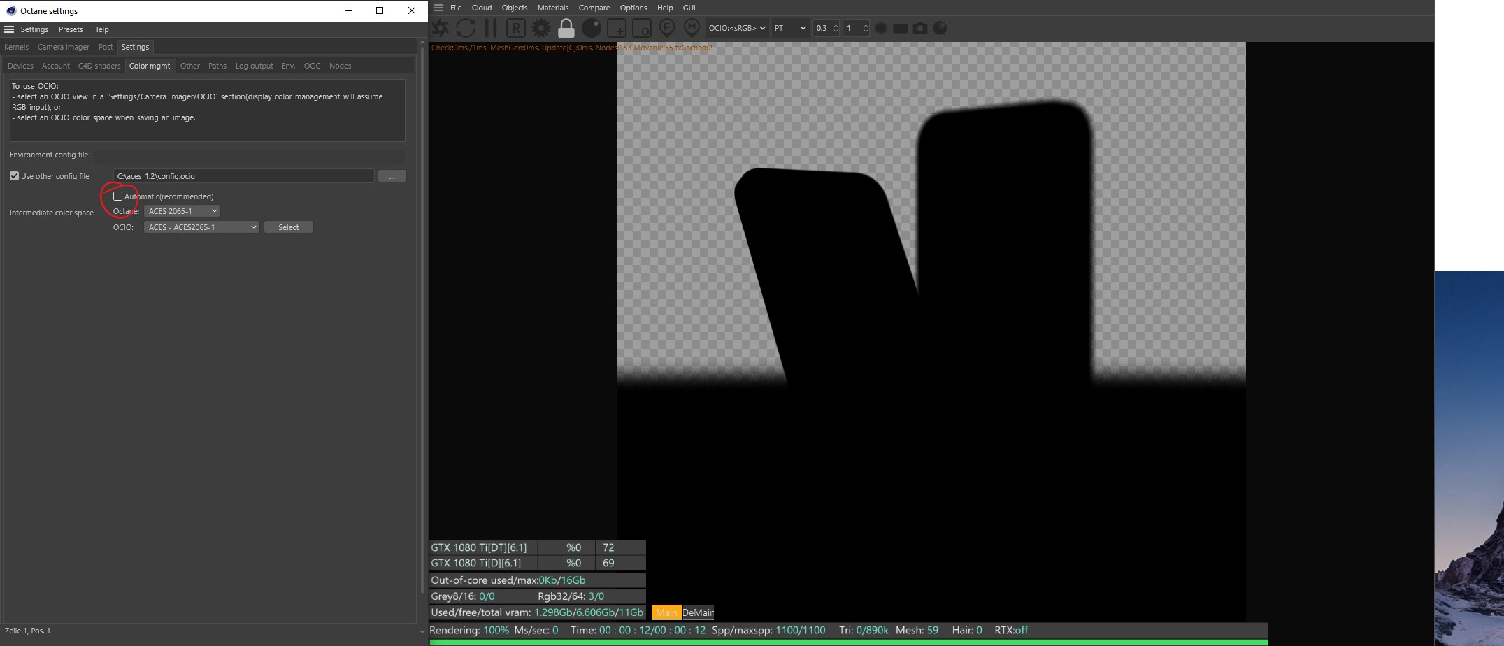

I found an issue with color management and OCIO.
If the checkbox "Automatic (recommended)" is not checked the render turns out completely black. Since I don't know what "Automatic" does I prefer to setup the color space myself.

From the Docs, here: https://docs.otoy.com/cinema4d/ACESOCIOQuickStart.html
"INTERMEDIATE COLOR SPACE
In the Color Management tab, the Automatic toggle will set up the Octane and OCIO intermediate color spaces for you. The Automatic toggle is enabled by default, which guarantees that the Octane and OCIO color spaces are in sync (as they must be for ACES/OCIO to work properly). To choose alternative intermediate color management, disable the Automatic switch, and additional choices will then become available. If you change these two settings, you must ensure they match each other. Some config.ocio files have a broader selection than others. The config.ocio file referenced in this topic offers only the ACES 2065-1 choice for Octane; therefore, the only option to use for OCIO is also ACES 2065-1."

hausgross wrote:Hi Ahmet!
Another issue I have has to do with multilayer output.
When I open old scenes with 2021.01 there are no multipass channels active and i found no way to see what was set up. Is there a way to automatically convert old style mp layers to the new AOV system?
I'll add a conversion command for that
