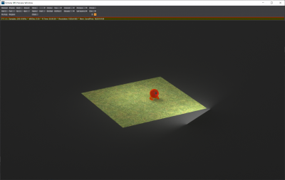

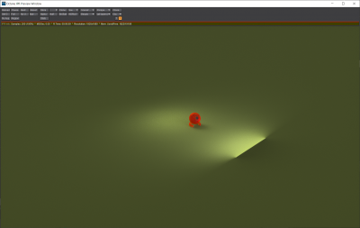

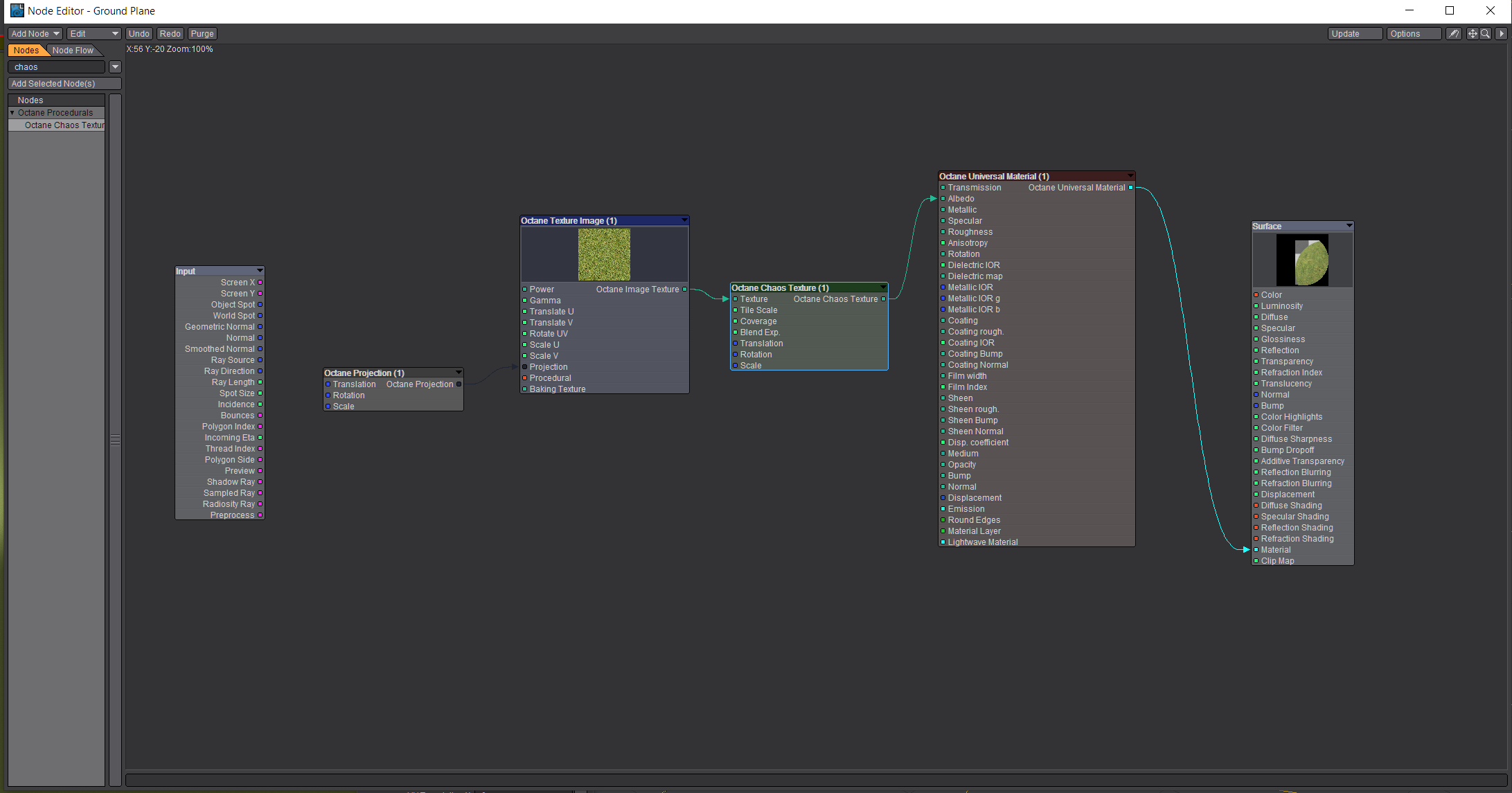

I'm trying to get the new Chaos node to work, but it doesn't seem to work the way I was expecting. Am I setting it up incorrectly or is this a bug?
So, in LW Layout, I have created a 10m x 10m plane. I've given it a seamless texture, and projected that onto the plane, scaling it (using a projection node) to 1m x 1m:
But when I attach the chaos node between the image node and Albedo input on the the universal material node, I get this:
It doesn't matter what I change in the Chaos Node settings, I cannot get it to display the size and detail of the original texture.
Also, show structure doesn't display the black triangles at all.
I'm using LW 2015.3 and RTX 3090.
