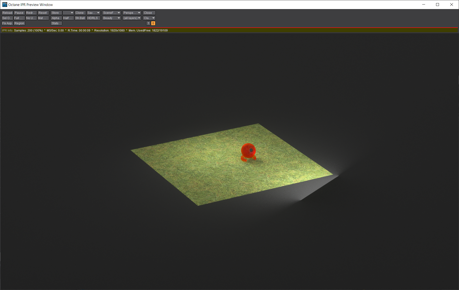

I'm trying to get the new Chaos node to work, but it doesn't seem to work the way I was expecting. Am I setting it up incorrectly or is this a bug?
So, in LW Layout, I have created a 10m x 10m plane. I've given it a seamless texture, and projected that onto the plane, scaling it (using a projection node) to 1m x 1m:
But when I attach the chaos node between the image node and Albedo input on the the universal material node, I get this:
It doesn't matter what I change in the Chaos Node settings, I cannot get it to display the size and detail of the original texture.
Also, show structure doesn't display the black triangles at all.
I'm using LW 2015.3 and RTX 3090.
promity
Posts: 363
Joined: Sun Dec 19, 2010 7:59 am
Location: Russia
It seems to me that this only works with objects that have UV.
