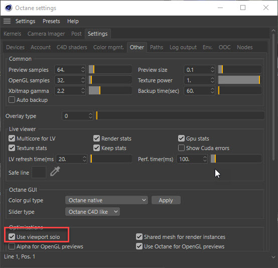

Are you having this parameter is selected?GIOLETS wrote:I have noticed a problem using Viewport Solo that seems to be not recognized as a geometry update by Live Viewer.
It happened with medium-large scene, not with ones with few objects.
Hi Ahmet!
I' haven't noticed the switch, but yes it was enabled. And with few objects, I've noticed that all worked well.
But today I've tried to re-create the problem with the same objects and magically all is working well now.
Thanks in any case!
I'll inform you if happen again and in what conditions.

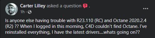

any idea on this:
source: https://www.facebook.com/groups/OctaneR ... 056883363/

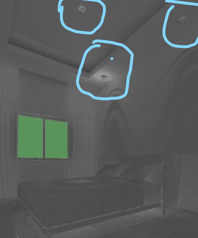

Hi, Aoktar!
Overall this plugin version is really stable.
One question: I have this interior scene in which I work with exterior light and interior spot lights: they are inside a cloner. INe of the spot cleans light very well while another struggles a lot to clean. Why does that happen? - Please refer to picture.
Regards,
Regards,
