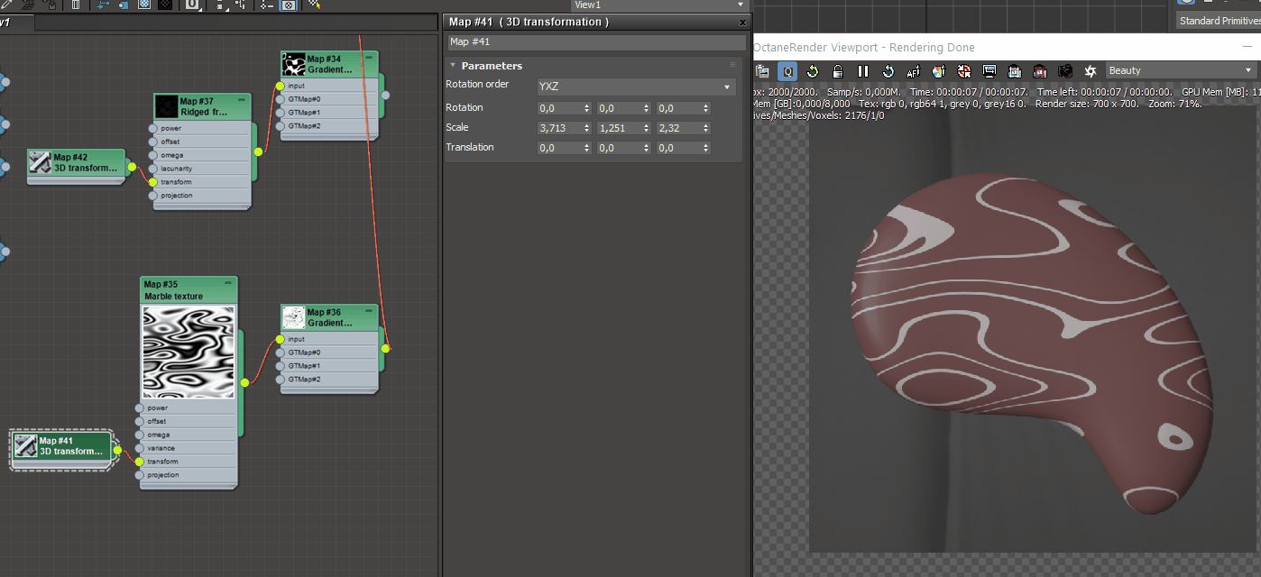

I need to "Rebuild scene" every time I want too see Procedural texture (in this case Marble texture) "3d transformation" changes.

ramone163 wrote:I need to "Rebuild scene" every time I want too see Procedural texture (in this case Marble texture) "3d transformation" changes.
Hi ramone163,
it's an SDK issue, should be solved with the next release 2020.2.2.
Regards

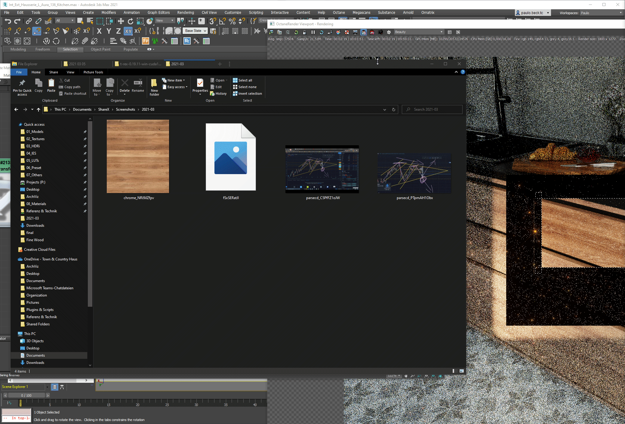

Posts: 393
bug?
mbetke
Posts: 1304
Location: Germany
Its SDK bug. Was discussed here in the thread :)
