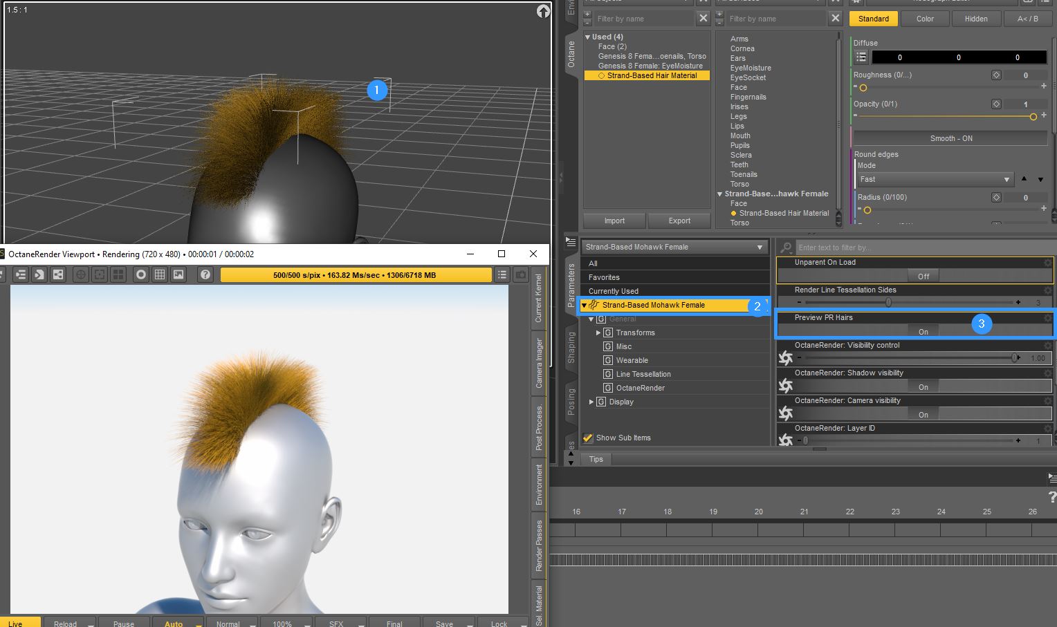

Some dForce hair still doesn't work even with the below settings:
dForce hair in Octane and iRay
Parameters for the hair
Under General:
Simulation Generate PR Hair: ON
Preview PR hair: ON
Line Tesselation:
Viewport Line Tesselation Sides : 2
Render Line Tesselation Sides : 3
Hi Tugpsx,
Thank you so much for reporting these.
Could you please try to disable/reenable the Network rendering option and see if the Master is able to bind the Render node?
Regarding the hair issue, where can we find/download it? We tried the sample and it rendered okay!

Hey BK. Regarding the hair, I believe the strand based hair itself is fine, it is the dforce hair that is the problem. THe dforce hair is the dynamic version of the strand based hair, but only the vendors at Daz are allowed to turn strand based hair into dforce hair to make it become dynamic. Some dforce hairs dont show up at all, some will work with the stated work around, but only for so long before octane stops rendering it. I just tried the dforce version of that mohawk and it doesn't show up at all. I imagine if iray can render it octane must be able to render it somehow.
Hi Sorel,
Thank you so much for explaining the workflow.
Totally agree with you!!
We are able to replicate this issue with Mohawk dforce version.
Adding this issue to our to-do list !!
