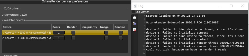

There is error while using device peers after restarting LV window :
This is related to Standalone too.
