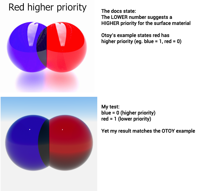

EDIT: You can ignore this post. After reading through the older release notes, I see this changed in RC5 so higher numbers now mean higher priority
viewtopic.php?f=33&t=76517
Original post below:
I'm confused about the nested dielectric priority docs in the 2020.2 XB1 thread
viewtopic.php?f=15&t=75728
It states:
The LOWER number suggests a HIGHER priority for the surface material, and a higher priority is preferred over a lower priority if a ray enters a higher priority surface and then intersects a lower priority surface while inside the higher priority surface medium.
It also contains an image example where red has a "higher" priority (which means lower value), yet I can only match the result by doing the reverse.
So it looks like a HIGHER value now translates to a HIGHER priority. Is that right? Are the docs wrong?
P.S. I was looking at the Arnold docs on nested dielectrics, and they decided to go with higher number = higher priority because it was less confusing.
https://docs.arnoldrenderer.com/display ... ielectrics
Quote from their docs:
It states:
Some other renderers have a lower number mean an effectively higher priority. We think this is unnecessarily confusing, so instead higher number corresponds to a higher priority, which overrides the lower number.

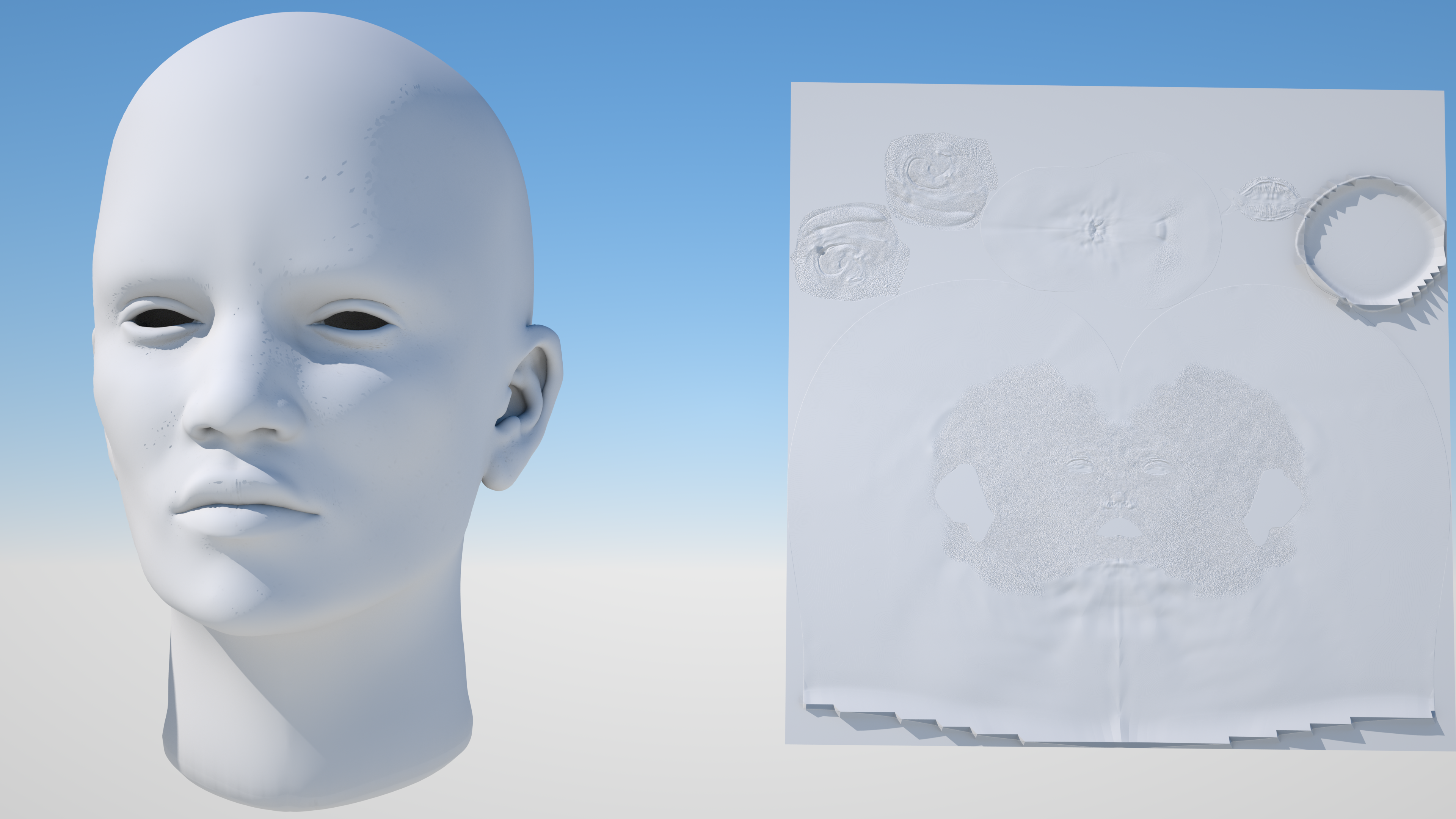

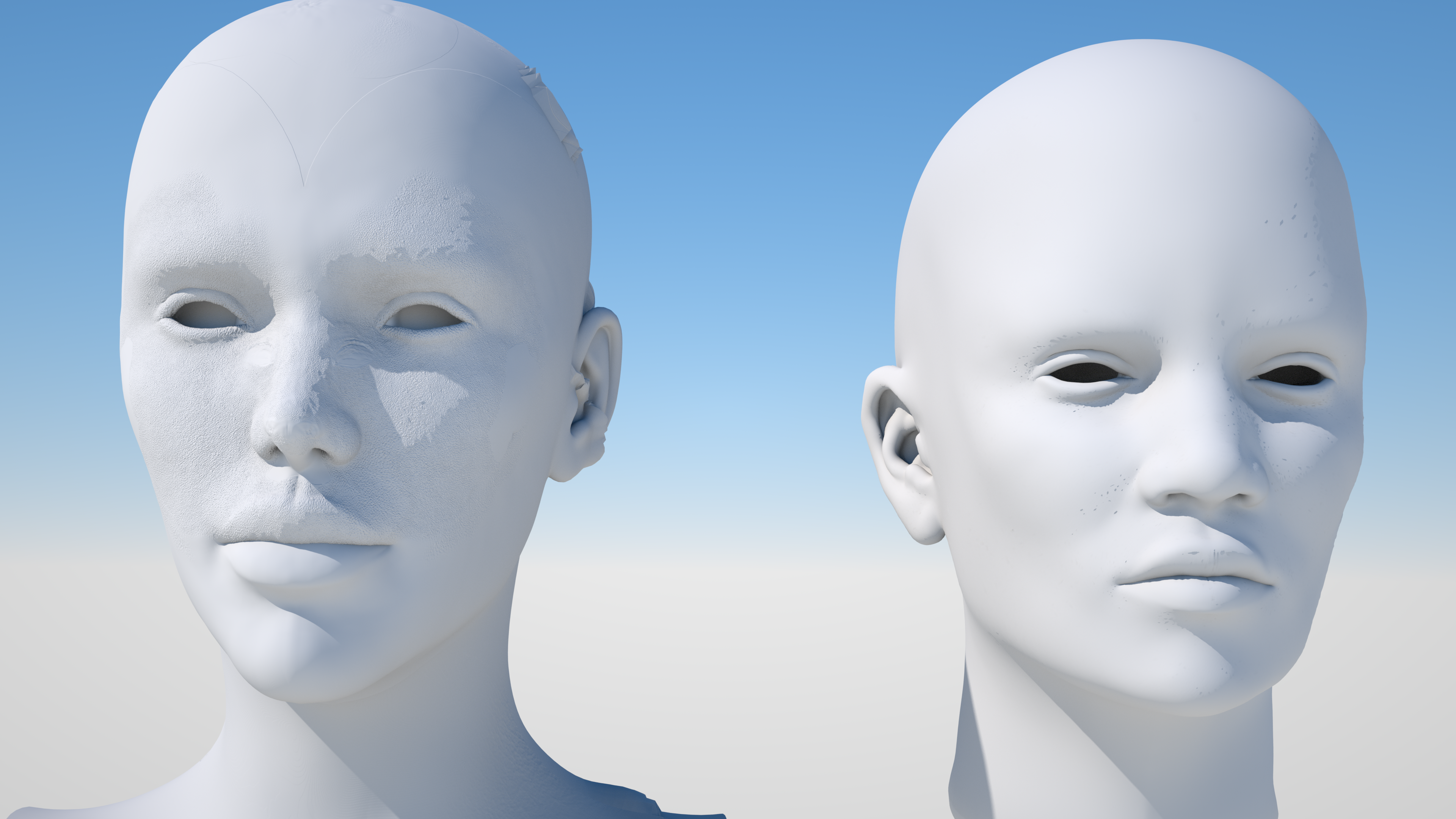

]There is something wrong with Vertex Displacement and autobump. It works on some models and not on others. In the first attached image you can see the problem. It doesn't work on the head but it works just fine on a plane. You can see the same thing on the third image, works on the left model but not the right one. They don't have the same uvs but that doesn't really matter. They were both exported the same way from ZBrush. Thought something was wrong with the model but i tested it in Arnold and Redshift and it works just fine there.
