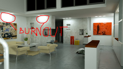

Is it physically correct? If I would try to illuminate the real interior of my room in the same way, and later took a picture I would not get such a burnings. I think there is something wrong with the material emitting light. I have a big problem with that in Octane Render in every engine: directlight, pathtracing, PMC.

Actually it looks like you should use IES lights in your setup to make it more physically correct, cause light usually isn't so diffuse like a mesh emmiter is.. still

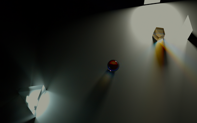

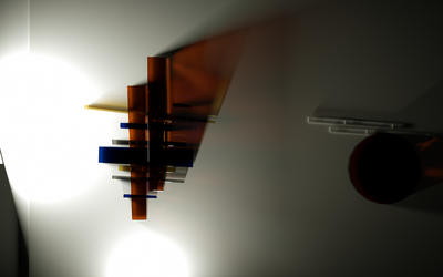

here's a composition with heavy caustics after a 1hour 15min at 1920x1080 - needs a very strong light source - so it also burns the image a bit - a secondary bounce increase feature would be quite beneficial

@FamilyGuy
How much watts are we talking about?

This is due to the fact that we have a linear tonemapper currently.
non-linear ones like reinhardt solve this issue. We will add one in the near future...
You can save to HDR images and use an external tonemapper with the 2.5 (which *should* (no promise) have HDR .exr output)
