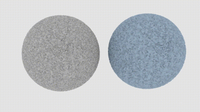

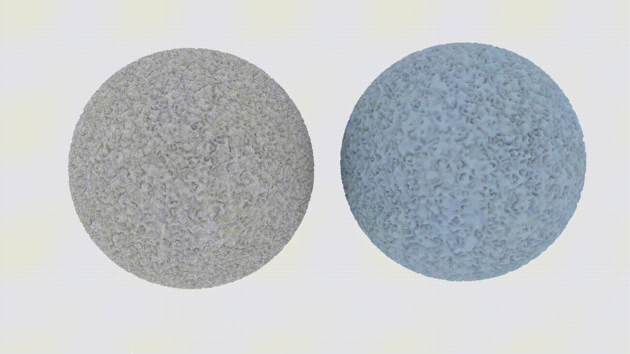

Regarding the autobump feature - I'm not sure if I'm doing something wrong here, but when animating with autobump enabled, it produces a strange strobing effect.
If you compare it to the blue sphere on the right, which has exactly same texture but autobump disabled (again, you might need to click the attachment to see the gif animate):

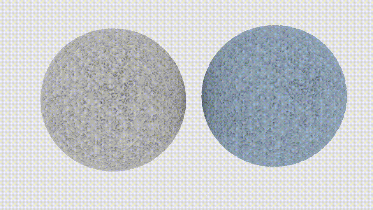

And I hope I'm not over-explaining this, but here's a version without autobump:

I'm not sure why both displacement and auto bump on the same node don't both behave the same way, but if you set Space to Object in the Noise node, too, it functions as expected.

frankmci wrote:I'm not sure why both displacement and auto bump on the same node don't both behave the same way, but if you set Space to Object in the Noise node, too, it functions as expected.
Space to Object in the Noise does fix it, thanks!
