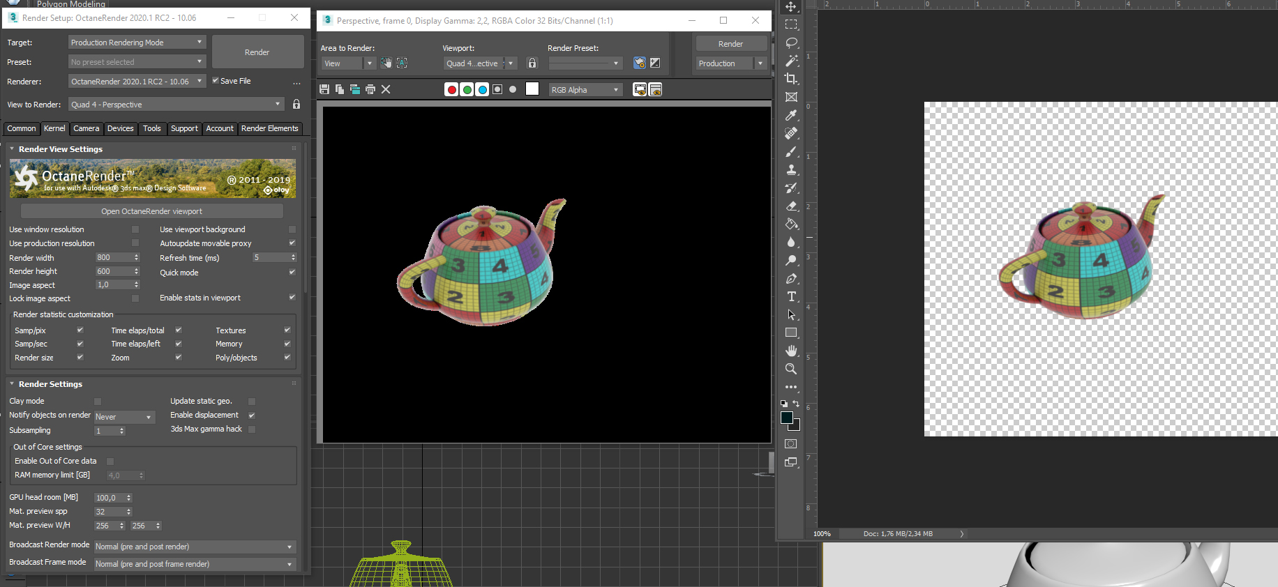

direct engine cannot save alpha channel PNG

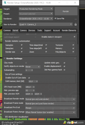

Started logging on 02.04.20 04:37:13
OctaneRender Enterprise 2020.1 RC2 (8000004)
CUDA error 2 on device 0: out of memory
-> failed to allocate device memory
device 0: failed to allocate post-fx buffer
denoiserThread0 : Not enough free memory to run the denoiser. Required memory 453.47 MB
denoiserThread0: CUDA_ERROR_OUT_OF_MEMORY: out of memory
. Restart required

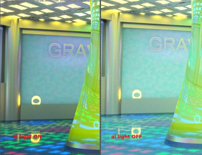

Hi coilbook,coilbook wrote:ai light off and on with rtx different brightness
are you using any dirt node?
Regards
Paride
