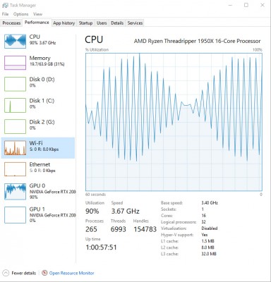

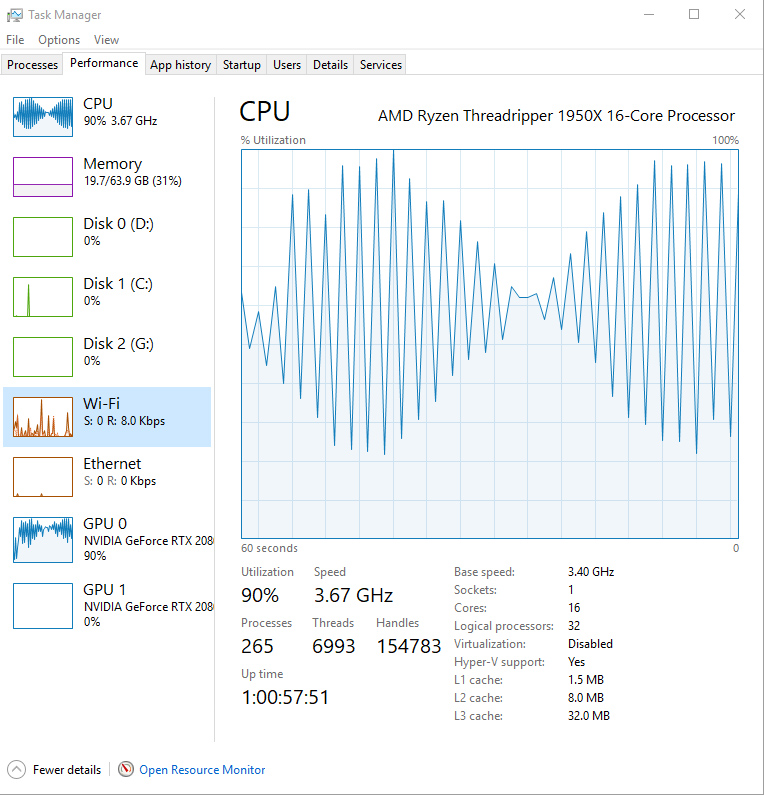

Just tested 2.79 , it was even slower than 2.8 . Same Spiking of the CPU. :(
I have added an image of how the graph of the CPU looks like.

The CPU graph looks a lot like a sine wave.. :/
Does it peg all cores or just some? (Switch the graph to logical processors)
