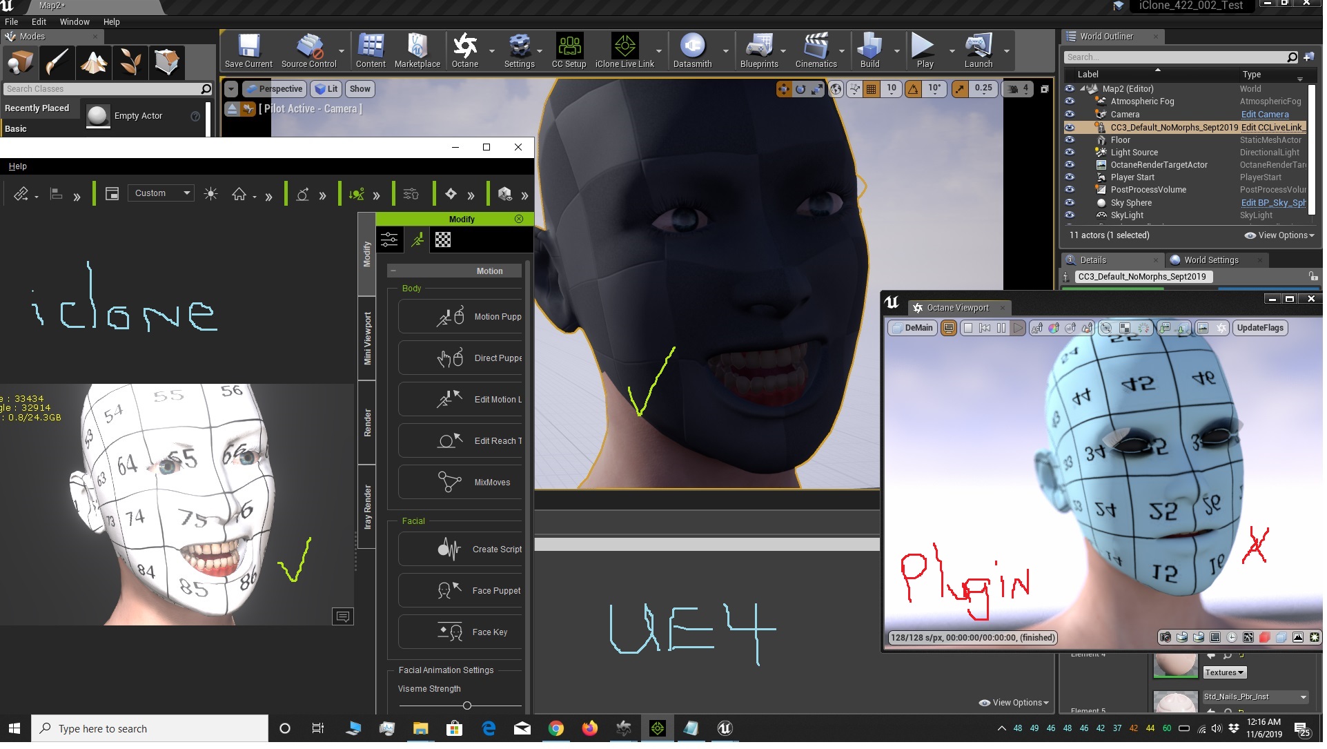

Uh Oh...
I just stumbled across something.
Plugin cannot respond to morph shapes can it....
I have a Live-Link to UE4 from iClone, where iClone generates morph shapes to UE4. The UE4 face moves around controlled from iClone, and the Plugin head likewise moves around, almost in Realtime.
But - the expressions and morph shapes, which do yes carry over to UE4, unfortunately do not then carry over into the plugin display.
So, the Plugin is not so much rendering the mesh 'shape' as much as it is converting it to an FBX-ish thing somehow, and thus can only 'mirror' hard bone-rig-type movements, but not morph blendshapes, right?... :cry:
Mobo: 1 Titan RTX, 1 Titan Xp
Plugs: Enterprise
ChrisHekman
Posts: 1101
Joined: Wed Jan 18, 2017 3:09 pm
Im going to try to add morphtargets to the next build. Which should be released this week, or start of next week.
