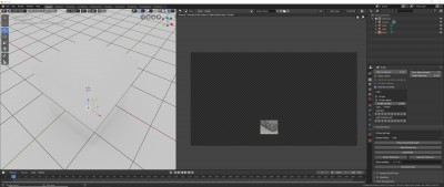

Hi, my card is showing as not available but render (RC2 only view port) works.
Cheers, mib

Ok fixed old thing but in new download it never finished the render https://imgur.com/Y50A8JO its just stuck on waiting for image

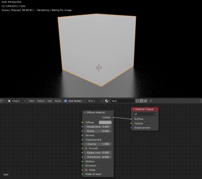

Looks like Emission is always ON for materials?
Suv
Standart diffuse material with no Emission !!

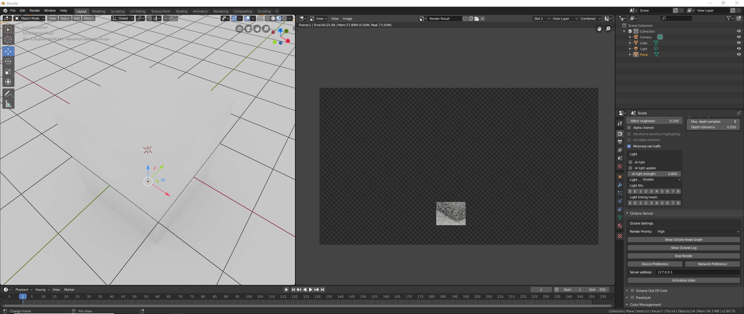

DrawFun wrote:
daryl.dunlap wrote:Viewport rendering works. But, doing a render (F12) doesnt seem to produce any image. Attached logs are from an render (F12) attempt.
The attachment Blender Render Empty.jpg is no longer available
Hello Daryl,
We have got this issue fixed and updated to Blender 2.8 RC3. Now the download link is updated. Please re-download it and happy rendering.
Cheers,
DrawFun
Thanks, I'm able to see "some" render output now, but its not what's expected. From what I can tell, the render (F12) is in interactive mode as it never cleans, its as if each pass is starting over from the beginning, firing a single sample.....instead of the noise resolving, it swims.
I did a render region, of maybe 100x100 pixels and let it go for 25seconds, and the attached is the result. The CPU was pegged at 100% during the render (F12) as well.
In comparison, 32 samples at full resolution in the viewport, resolves in .65 seconds.
