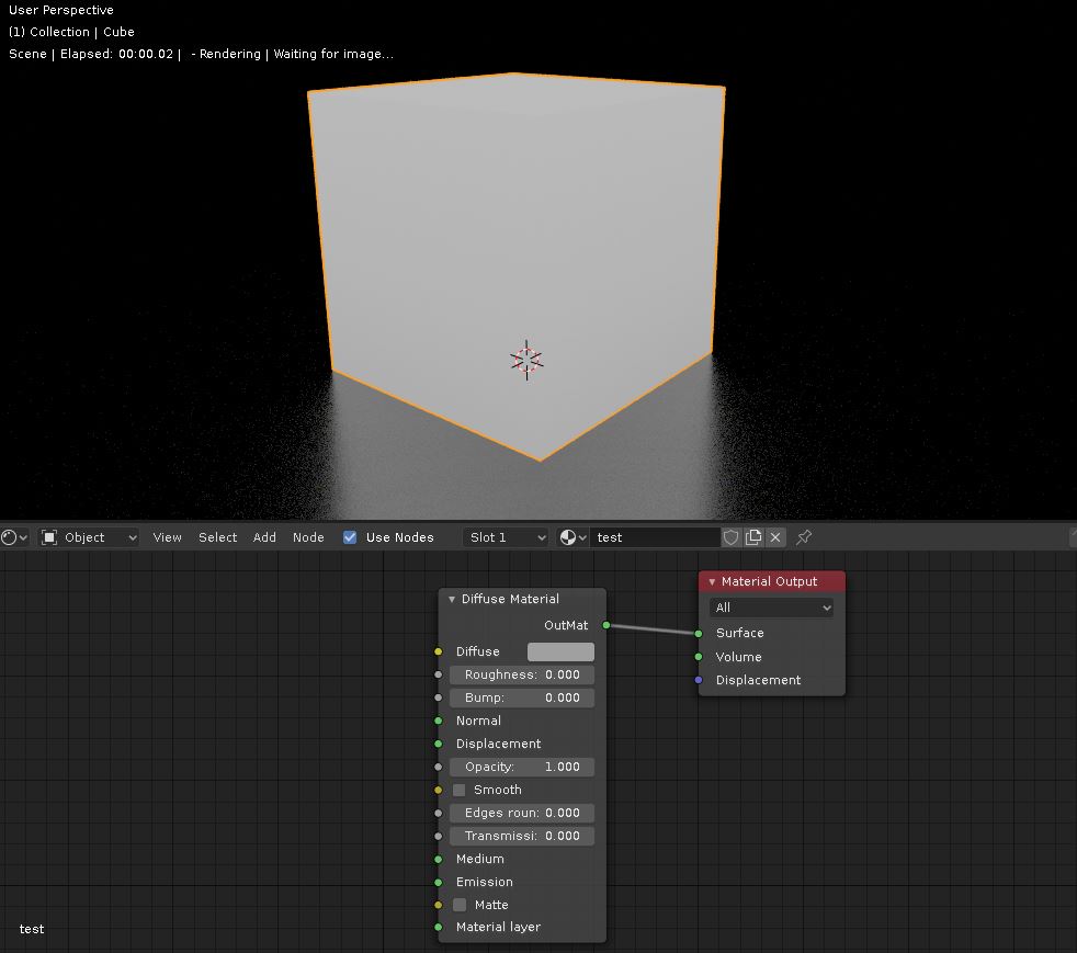

Thanks, I'm able to see "some" render output now, but its not what's expected.  From what I can tell, the render (F12) is in interactive mode as it never cleans, its as if each pass is starting over from the beginning, firing a single sample.....instead of the noise resolving, it swims.
I did a render region, of maybe 100x100 pixels and let it go for 25seconds, and the attached is the result.  The CPU was pegged at 100% during  the render (F12) as well.
In comparison, 32 samples at full resolution in the viewport, resolves in .65 seconds.
