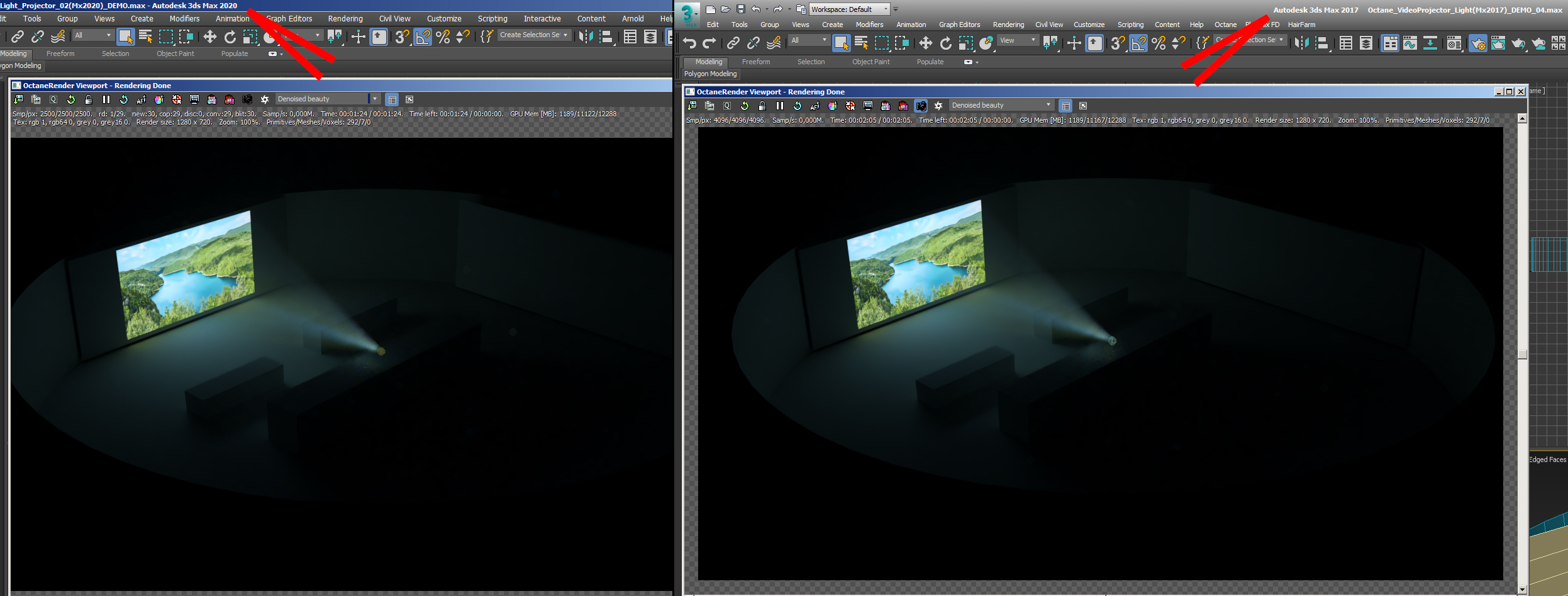

Texture light projection from Octane planelight on 3DS MAX
Here they are for Max 2020 and max 2017
- Attachments
- Octane_VideoProjector_Light(Mx2017)_DEMO_04.zip
- (497.92 KiB) Downloaded 251 times
- Octane_Light_Projector_02(Mx2020)_DEMO.zip
- (553.27 KiB) Downloaded 249 times
