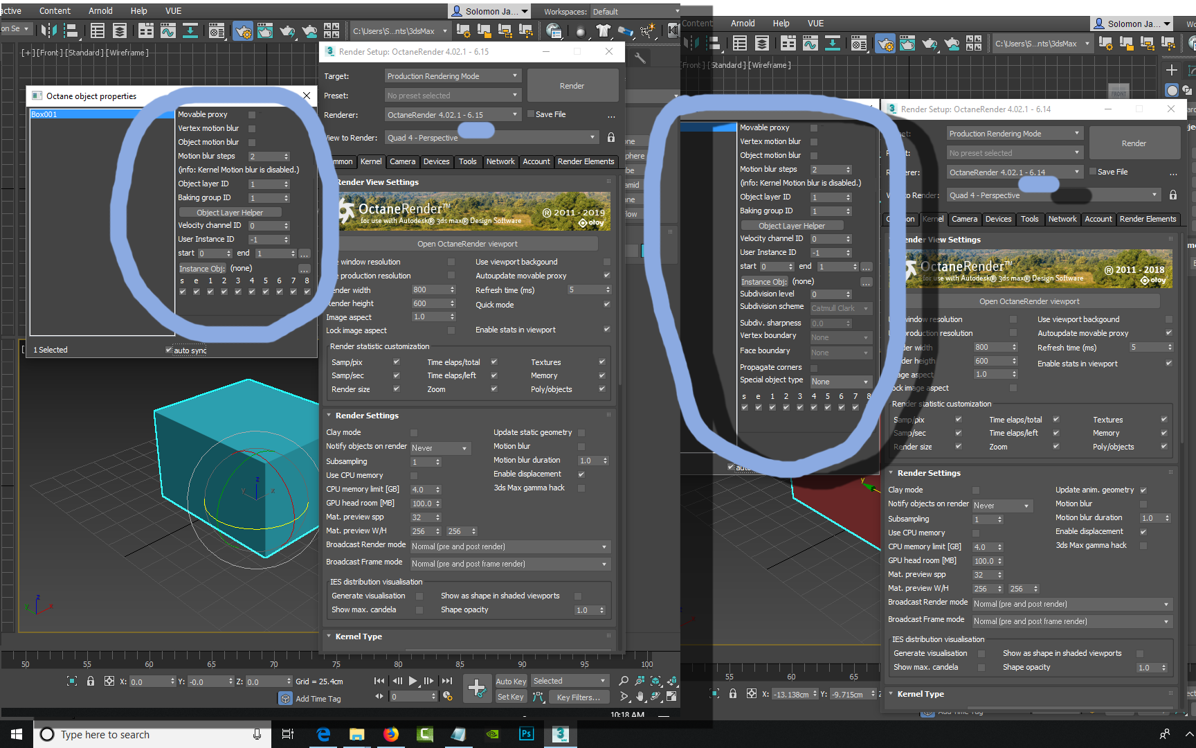

Hi Guys,
I just noticed that some aspects of the Octane objects are missing in this version, which were present in 6.14 ~ where can I find these settings?

solomon wrote:Hi Guys,
Hi Solomon,
developers are moving some features to 3dsmax modifier:
viewtopic.php?f=27&t=70773
Regards
Paride
