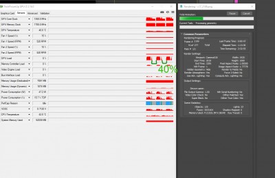

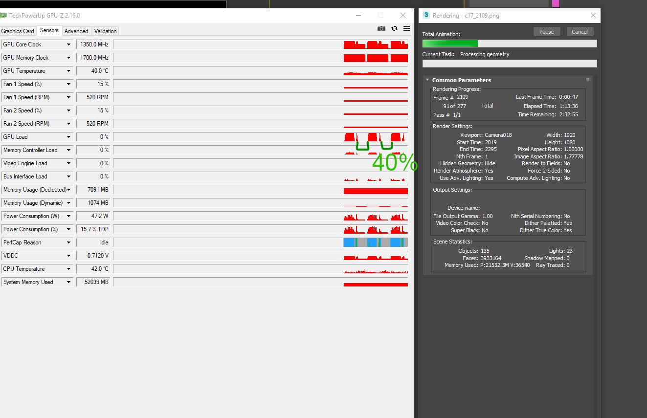

RT cores are nice but 40% of render time is still wasted for eval times for a good size scene. And that a lot. Hopefully you guys will come up with faster eval times. The rendner time is small only because we use 20 GPUs but eval times looks big since they render so fast.Goldorak wrote:It is now allowing you to do offline rendering with complete material and scene ingestion, and with Octane nodes fully and completely integrated in the existing UE node system (which was a lot of work!). Baking (and light field baking) will come later in the beta. Octane 2019 won't require RTX, but it will render some scenes much faster when RT Core HW is present.Notiusweb wrote:Speaking of RTX - I see the videos online of the 4.22 preview Version of Unreal Engine, raytracing with the RTX 2080Ti.

It shouldn't take more than a few seconds to load a 4 million poly scene (which is what it looks like you have ) in V4 or later. Unless your frames render in less than 6 seconds, I suspect there is some overhead int he Max plug-in that is causing the 40% usage, and as before, perhaps we need Cristophe to help look into this. Can you try exporting this to ORBX and run a batch render and see if the eval times are the same?coilbook wrote:

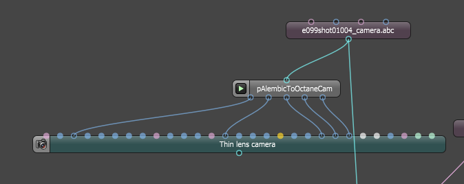

We use a script to give an ABC alembic file all the 'thin lens camera' options (see screen shot). So we can adjust the amount of depth of field for example.
The problem with this is that the potion is not going through the node so octane does not know the camera is moving.
So when we use this node we do not have camera motion blur. This there a way we can fix this? Or can we have the thin lens camera option when we load in an ABC of FBX camera?
I attached the script, and screenshot and an file (orbx).

HiGoldorak wrote:It shouldn't take more than a few seconds to load a 4 million poly scene (which is what it looks like you have ) in V4 or later. Unless your frames render in less than 6 seconds, I suspect there is some overhead int he Max plug-in that is causing the 40% usage, and as before, perhaps we need Cristophe to help look into this. Can you try exporting this to ORBX and run a batch render and see if the eval times are the same?coilbook wrote:
I've already sent two scenes about a month ago. I attached the video. it takes about 18 seconds to eval the scene with 14 mil polys plus itoo forests.
Why cannot you guys develop a very complex scene full of vegetation, displacement ground, vdb fog, etc to test for eval times and bugs.
I think you should work with iToo to optimize loading time of itoo objects especially when camera moves and itoo objects must be reloaded and are locked to a camera view
