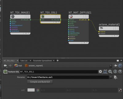

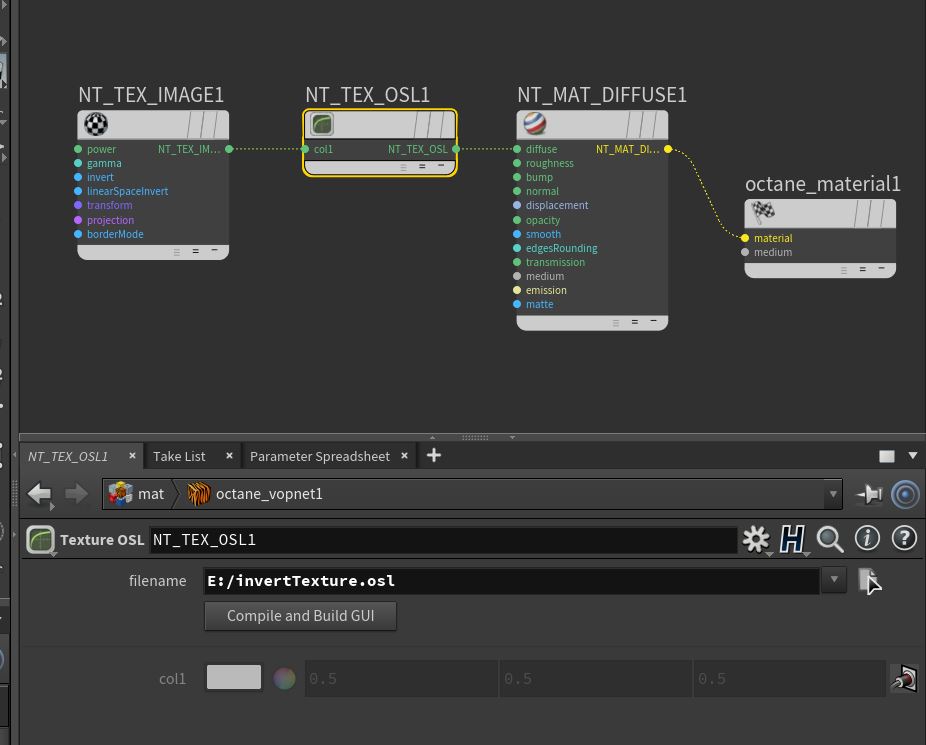

Help me pleae with invert normal with OSL
I write this script to .osl and put to osl_texture in shader builder. in houdini dont apear any imput for texture (
#include <octane-oslintrin.h>
shader Texture(
color col1 = color(0.5, 0.5, 0.5),
output color c = 0)
color col2 = _evaluateDelayed(col1, u, v);
c = color(col2[0], 1.0 - col2[1], col2[2]);
juanjgon
Posts: 8867
Location: Spain
seriawp wrote:Help me pleae with invert normal with OSL
Sorry, my mistake. I'm afraid that currently the final OSL VOP nodes with exposed inputs are available in the 2018.1 plugin builds only. The changes made in the plugin code to support this feature were done along the 2018.1 development cycle and they are too complex to commit them back into the 4.02 plugin branch.
As you can see in the attached image, your OSL shader works fine in Octane 2018.1 ... not sure if you have access to it to test it there.
Thanks,
-Juanjo
