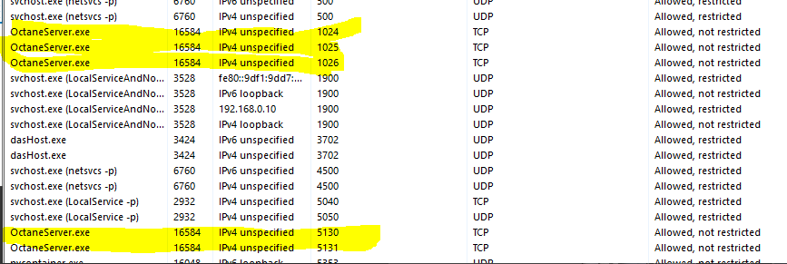

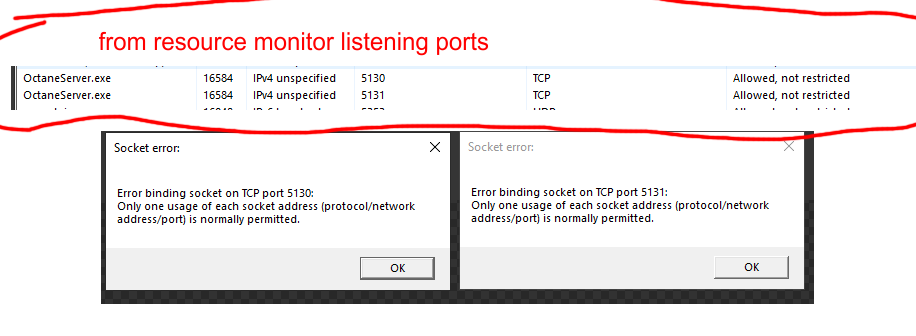

Posts: 476
Joined: Thu Sep 11, 2014 7:30 pm
Hi Drawfun and JC,
So...I have a render going...(wait, actually it just crashed on frame 159), and simultaneously seeing the above image. Not sure exactly when the errors came up, as they usually appear behind the Blender App.
I notice them when minimizing the program or floating the cursor over the ORserver icon in my taskbar.
Am I supposed to see 2 instances of the OctaneServer in the listening ports?
You have to forgive me, but this is all Greek to me.
I have added an image corresponding to the restarted render...more port info. Render seems to be going ok now.
thank you for your help,
Rick

I have noticed that some times OctaneServer will not quit and I have to kill it manually. Doesn't happen often, but you can get these kinds of errors when it happens. It might be something different too as I'm on Linux, so YMMV. :)

There should be only one instance of the OctaneServer running on your system. Is it starting when you boot up your system?
When you run Blender-Octane the order is arbitrary. You can run Blender or Server first. Just double check if another server instance is not running.

With a single instance of the OctaneRender Server running, I definitely have the Octane Server on Listening ports 1024, 1025, 1026, 5130, 5131.
Something to do with dual CPUs and 4 cards?
J.C
Posts: 1870
Joined: Thu May 13, 2010 6:35 pm
Location: Wrocław
On my system Octane Server has also several ports opened:
proto: tcp4 addr.port: *.5130
proto: tcp4 addr.port: *.5131
proto: tcp4 addr.port: *.1026
proto: tcp4 addr.port: *.1025
proto: tcp4 addr.port: *.1024
