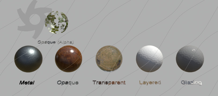

face_off wrote:
I will post tomorrow how I would assume the converted universal material looks like.
Great work on this - thank you. If you could also post a .RVT which contains those physically based materials attached to the spheres that would help immensely.
Paul
I worry I can't publish that file here, sorry, though the materials setup is really simple as you can see from the screenshots.
During the test I experience the same issues with the smoothed normals as described here viewtopic.php?f=61&t=70522
The problem only affects geometry which is not generate parametrically in Revit e.g. imported meshes.
I rotated the spheres back due to that issue.

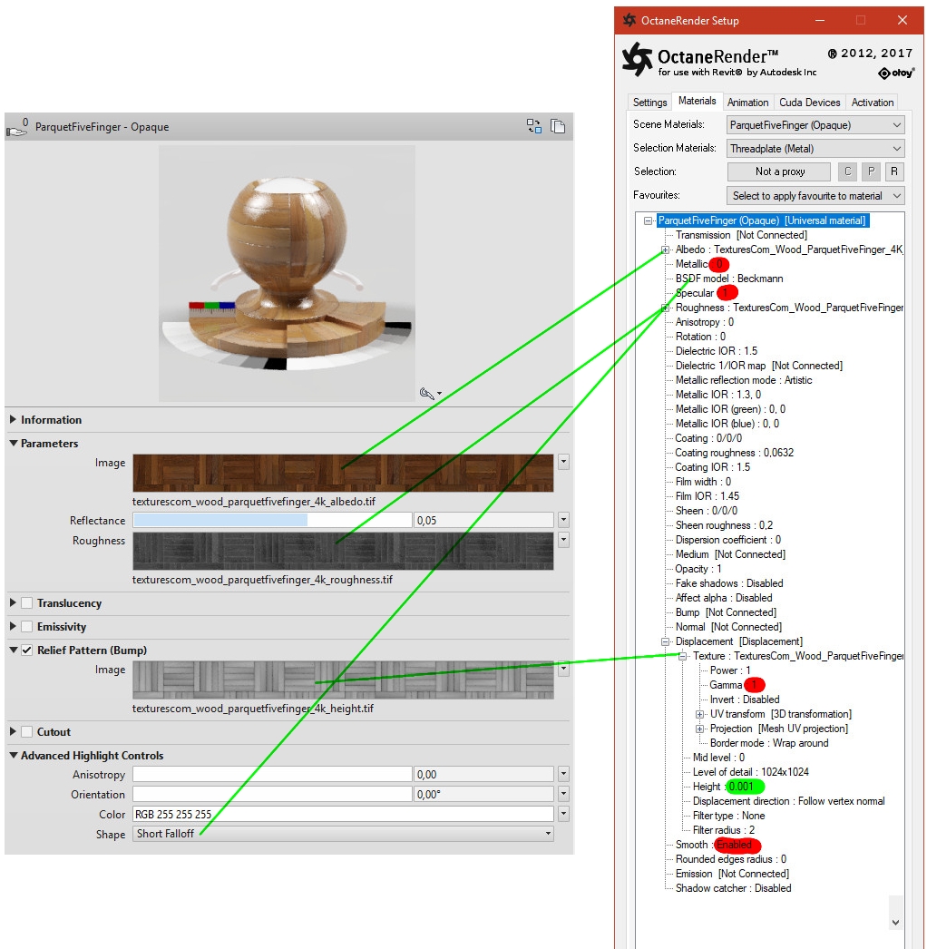

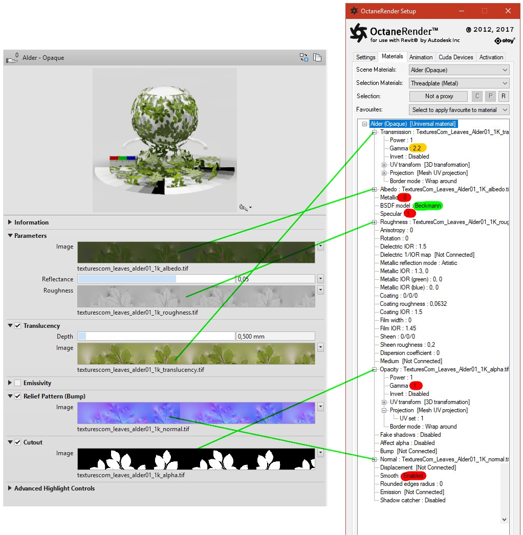

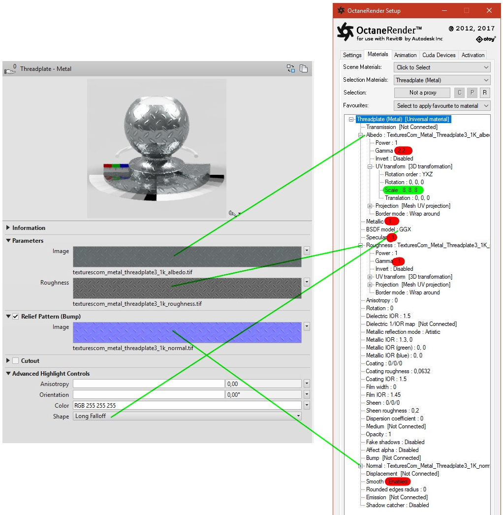

Proper converted materials should look like this in Octane.
Not sure what is going on with the backfaces on the leaf material, transparent is a bit strange and forget the last 2 for now :lol:
I tried to markup how the conversion should be done.
Green marks converted values, red are fixed values which should be set.
1. Metal
- Hightlight shape "Long Falloff" translates to BSDF model GGX, short stands for Beckmann.
- All (used in this examples) textures need gamma setting of 1 except albedo, though I'm not 100% sure for transmission.
- Proper texture scaling for all textures should be converted.
- Inside Relief Pattern (Bump) settings is a switch for either normal or height map, that needs to be evaluated somehow and converted accordingly.
- Smooth should be default imo
2. Opaque
- this example uses height map in the Relief Pattern (Bump) slot
- Height value could be converted
3. Opaque with Cutout
- this example uses normal map in the Relief Pattern (Bump) slot

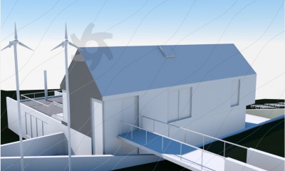

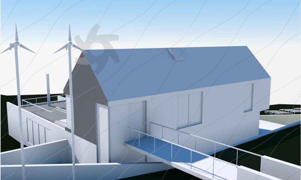

There is not much more information I could provide.
I load a scene (new, sample or existing), I can choose a material from the pull down list but the parameter list is completely empty.
Here is a render example of a sample scene.
I worry it is some kind of individual issue, like the one I originally posted, though I don't have a workaround, except downgrading.
