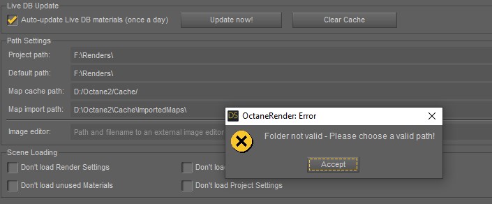

Hi Paul,
I am getting the Folder not valid error often when I change the Map import path under Preferences. The folder is valid. But every time I select it, it gives that error.

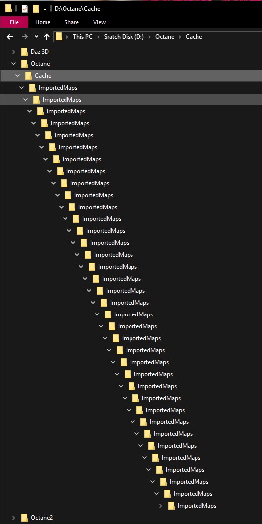

Also by mistake if one selects the Map cache folder as the Map import path folder and then try to correct the Map import path then it recursively copies the folders under Map cache to ImportedMaps and if one does not kill Daz Studio within seconds it creates thousands of sub folders and basically all the disk space would get eaten up.
Recursive ImportMaps folder creation

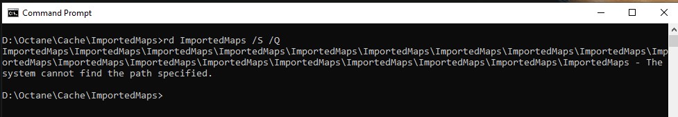

This to me is a serious bug. User will just keep waiting for the moving files dialog to close and in the meantime in the background it will be recursively copying the folders and if this happens on the c: drive and that becomes full, there will be trouble. And after a certain number of sub folders are created, SHIFT+Del does not delete the sub folders. Also trying to delete from the Command Prompt (CMD) does not work as the path becomes more than MAX_PATH. So now I am stuck.
Error in deleting from the command prompt.

I finally had to format my disk to remove the thousands of sub folder that were created. Luckily for me that disk I only as a cache disk so nothing important was there.

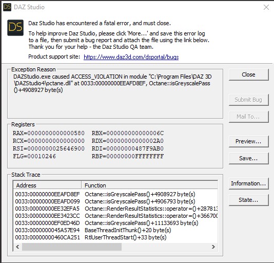

Hi Paul,
I have started to get the crash on the new system. This time in a different Octane API. I was adjusting the OnMyBrows (Eyebrows) parameter within Daz Studio parameter tab while the Octane Render viiewport was open and rendering when it just crashed.

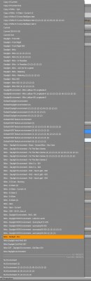

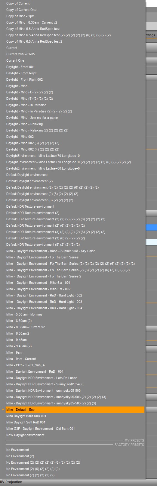

While loading my older scenes, I have started to see "bogus scene path" and "could not find file or directory 'assets\<...>' a lot and it looks like you have taken care of cleaning those when the file is saved again. The next time the file is opened after saving, those entries are no longer there in the log.
Similar to this can I ask an option to clean up the environment setting and render settings list drop down ? I have scene files with way too many render setting and environment setting listed as i experimented with the settings and saved them.
Example Environment list with too many items.
I can think of 2 ways to implement it. One - provide a delete button next to the item within the render setting / environment setting list so that we can click that to remove all the unwanted ones; or two - at the time of saving, show a popup with all the render setting / environments setting list and allow user to select and delete unwanted ones. This will help to clean up the scene files.
Or can I get the format and section in which these are stored in the DAZ duf file ? I will then write a script / plugin that will provide that option to the users to clean up the render settings / environment settings.

rajib wrote:Hi Paul,
Best regards,
Rajib
I did try to open the DUF file and search for one of my Environment Setting name but could not locate it. If is under some BASE64 encoding ?
Can't you just select the Environment and click the X button to delete it?
You will get that error if you try to change the Map Import Path to the Map Cache Path + "ImportedMaps". I /think/ this is a bug, so I will remove this check in the next release.
I will put a check in to make sure you cannot do this.
