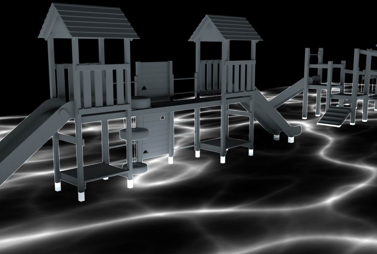

Hi, I don't know if it is 6.09 specific, but when using a black body on a diffuse material with transpency map, with transparent emission unchecked , surface emission checked and visible on specular unchecked, I get a white edge around the objects.
I render with alpha, and compose it with a black background in PS.

HHbomb wrote:Hi, I don't know if it is 6.09 specific, but when using a black body on a diffuse material with transpency map, with transparent emission unchecked , surface emission checked and visible on specular unchecked, I get a white edge around the objects.
Hi HHbomb,
It's quite normal what happens in your render; using diffuse material would not happen. A workaround is to put falloff node in roughness slot.

HHbomb
Posts: 1438
Hi, Paride, but I have "visible on specular unchecked" in black body...
Here is the same render with a diffuse material applied to all objects.

HHbomb wrote:Hi, Paride, but I have "visible on specular unchecked" in black body...
HI HHbomb,
sorry, I'm probably doing something wrong, caould share your scene (in pm if you want) please?
Regards
Paride
