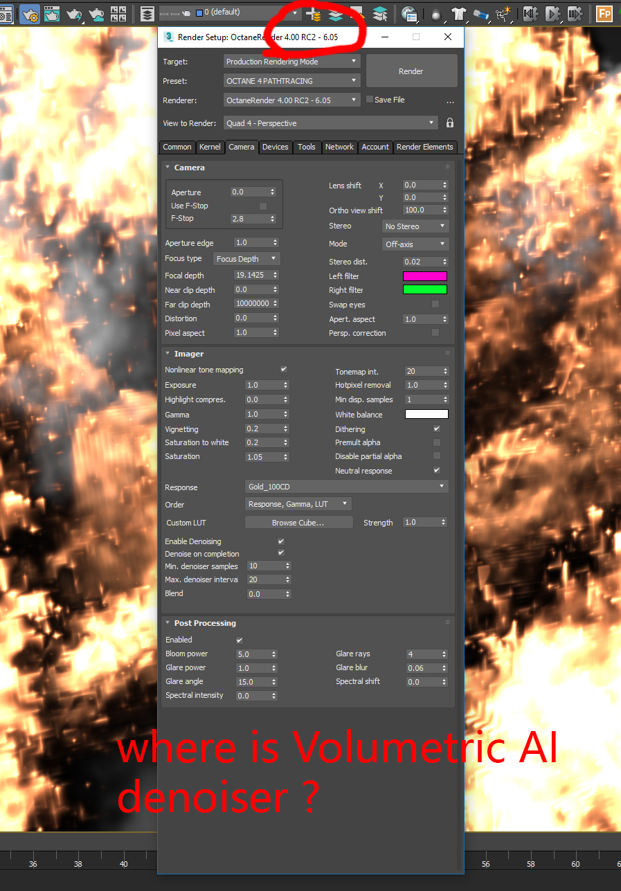

HI Paride,
could you please tell me where to find Volumetric AI Denoiser? Regular denoiser is not denoising volumes.

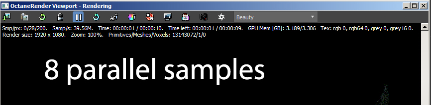

Well..I'm actually concerned about something I think weird between Version used OR my card having problems? , I think there is a big issue with the COPY/MIRROR/Istance ( and that goes for the XB3 6.03 which is still the one that gave me no issue UNTIL using the Copy ). What I did:
Open The file and Merge the big bathtube reaching that 3 gigabyte mem used and about 9. something million Primitives.. the RC2 was slow in evaluating and SLight unresponsive BUT id did render ( which is not the problem ) and after a good while it Denoised without Crash BUT I did notice that anytime it does reach the Samples set for the render and you switch for the denoise it saves automatically and I think that does interfere with it making it unstable..
Then I re opened the file in the XB3 6.03 and Copied a big geometry.. Crashed
Then again I did merge the same object in hi Poly and reached as far as 12 millions primitives BUT as soon as I reach 3gb Vram it gives me no Vram available for denoise and GPU fail?? ??? is there any script or test I can do to actually see what is going on?
I managed to scatter ( copying ) a 1. million smething object and I reached as far as 3.3/4 Vram used but then ..weird..I can pass the file to you and try to rise the number of scatering ( native 3dsmax ) or if you have a test file in hi Poly number I can test that should go with a 8Gb ram card?
edit: Best test I could made, see the attachment Viewport and overall unresponsive system with HUGE lags..not crashing but near.. ONE THING..see the max samples set at 200? the render did not stop and kept running? surely is not working as expected..especially the out of core..slow .actually can we know how slow should it go comapre to normal VRAM?

coilbook wrote:HI Paride,
Hi coilbook,
The volume denoiser will be available in next release, 6.06
Also an option to save denoised beauty output instead of the normal output, as well as texture compression support and channel format for Image tiles texture. Comming soon..
Thanks,
Hi coilbook,
Thanks,
Thank you. Maybe before you release it you can look into this octane 4/3ds max bug where it gets stuck at processing geometry viewtopic.php?f=81&t=68623

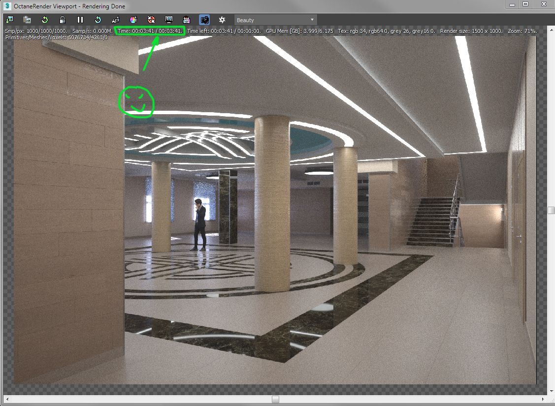

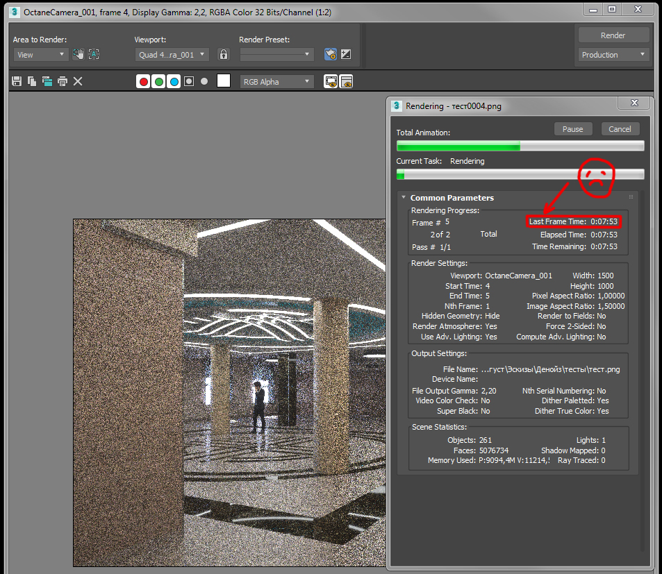

Tema wrote:Render animation time from 3ds max window, 30,35 minutes. The same frame in the octane viewport rendering 14-16 minutes. Correct this difference, please. I have to rendering an array of frames manually.
Hi Tema,
are you also considering evaluation time using OctaneRender viewport?
try to set no movable proxy all objects that are not moving in your animation.
Regards
Paride
A proxy has been set for all objects. The result is such as I wrote above. Below is a screenshot of the test.

Hi justix,
hard to say something about it, could you share your test scene in pm, please?
Before that, you could try reducing parallel sample in Kernel panel.
Regards
Paride
Hi Tema,
Regards
Paride
Hi Tema,
try testing with 3 frames, has 2nd and 3th same render time?
Regards

I wil ltry that, can't send you the scene in PM as it is about 700MB and it seems bouncing back at me.. but I can send you the obj and you can copy X 9 and see were you can actually push it? all test done does hault me past the 3.2 /4 GB Vram...
edit: error denoiserThread1 : Not enough free memory to run the denoiser. Required memory 475501728.00 MB ?????????????????? Parallel Samples set at 8 and even at 4.. and also well laggy....
Does 3dsmax rely on any HD cache or something? I have a 500 SSD primary and going lower the 100 BUT I moved the cache to a Tera still no changes.. just wondering
Win 7 64 | 2 X MSI AERO GtX 1070| Intel I7-6850K| 32 GB DDR4 RAM | Asus X99 II-A
