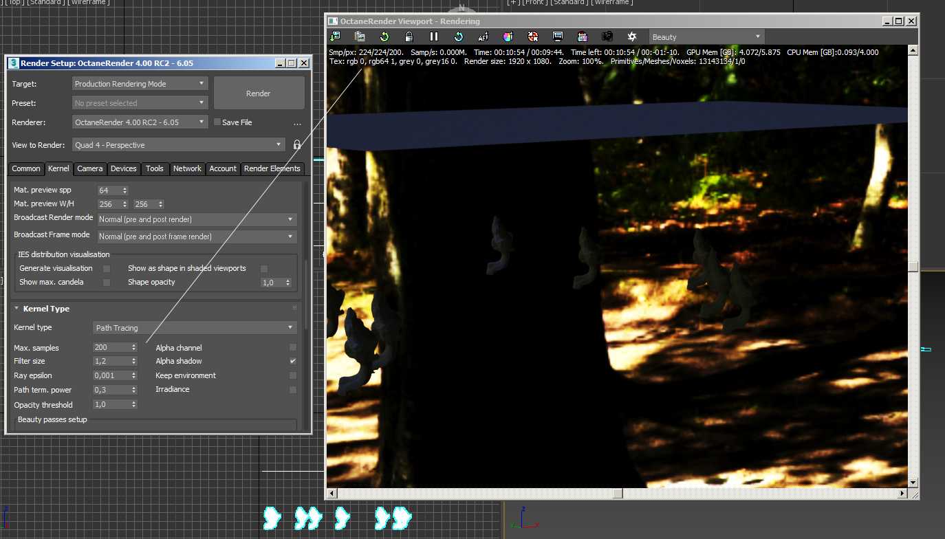

Open The file and Merge the big bathtube reaching that 3 gigabyte mem used and about 9. something million Primitives.. the RC2 was slow in evaluating and SLight unresponsive BUT id did render ( which is not the problem ) and after a good while it Denoised without Crash BUT I did notice that anytime it does reach the Samples set for the render and you switch for the denoise it saves automatically and I think that does interfere with it making it unstable..
Then I re opened the file in the XB3 6.03 and Copied a big geometry.. Crashed
Then again I did merge the same object in hi Poly and reached as far as 12 millions primitives BUT as soon as I reach 3gb Vram it gives me no Vram available for denoise and GPU fail?? ??? is there any script or test I can do to actually see what is going on?
I managed to scatter ( copying ) a 1. million smething object and I reached as far as 3.3/4 Vram used but then ..weird..I can pass the file to you and try to rise the number of scatering ( native 3dsmax ) or if you have a test file in hi Poly number I can test that should go with a 8Gb ram card?
edit: Best test I could made, see the attachment Viewport and overall unresponsive system with HUGE lags..not crashing but near.. ONE THING..see the max samples set at 200? the render did not stop and kept running? surely is not working as expected..especially the out of core..slow .actually can we know how slow should it go comapre to normal VRAM?
hard to say something about it, could you share your test scene in pm, please?
Before that, you could try reducing parallel sample in Kernel panel.
Regards
Paride
edit: error denoiserThread1 : Not enough free memory to run the denoiser. Required memory 475501728.00 MB ?????????????????? Parallel Samples set at 8 and even at 4.. and also well laggy....
