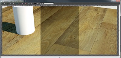

You are very welcome!darkline wrote:coilbook wrote:Try to set backup intervals to 0. Seems like this glitch happens every 15th frame. Maybe it will fix it. I have the same problem with wetmaps when octane will render wetmaps to whatever backup interval is set to freezing the renderer. Hopefully otoy will fix these 2 bugs.darkline wrote:still producing render glitches with phoenix (Max 2014) demo version of Phoenix FD 3.03
Here is my bug post with wetmaps viewtopic.php?f=81&t=64967
Coilbook, I love you.Ive literally spent the whole day, simulating, rendering, re-simulating, rendering, installing different versions of octane, upgrading GPU drivers, installing security updates to let even newer versions of octane install, and installing different versions of Phoenix - none of it helped and it all came down to this little bug! Thank you!!!
I can now actually get on with using this properly tomorrow

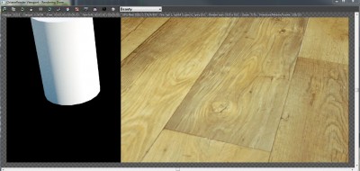

Im getting all sorts of problems now. Ive made a few changes such as installing latest octance needed lates nvidia drivers, plus the windows security update and I'm getting very unstable performace :
"Render failure in viewport rendering : Gpu Failure. check log for error detail"
I'm getting images when it does open like the attached below.
Also when it does work Im getting no volume now for my phoenix smoke.
Can you recommend a combination of gpu drivers and octane version that will render smoke stably please?

Try uninstalling your Nvidia drivers using DDU Uninstallerdarkline wrote:Im getting all sorts of problems now. Ive made a few changes such as installing latest octance needed lates nvidia drivers, plus the windows security update and I'm getting very unstable performace :
http://www.guru3d.com/files-details/dis ... nload.html
Install Nvidia drivers 388.13.
Regards
Paride

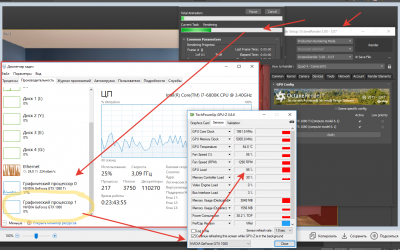

Hi GoldisartGoldisart wrote:GPU-z writes that all graphics cards are involved and Windows Manager shows nonsense
GPU-z doesn't lie,
Regards
Paride
