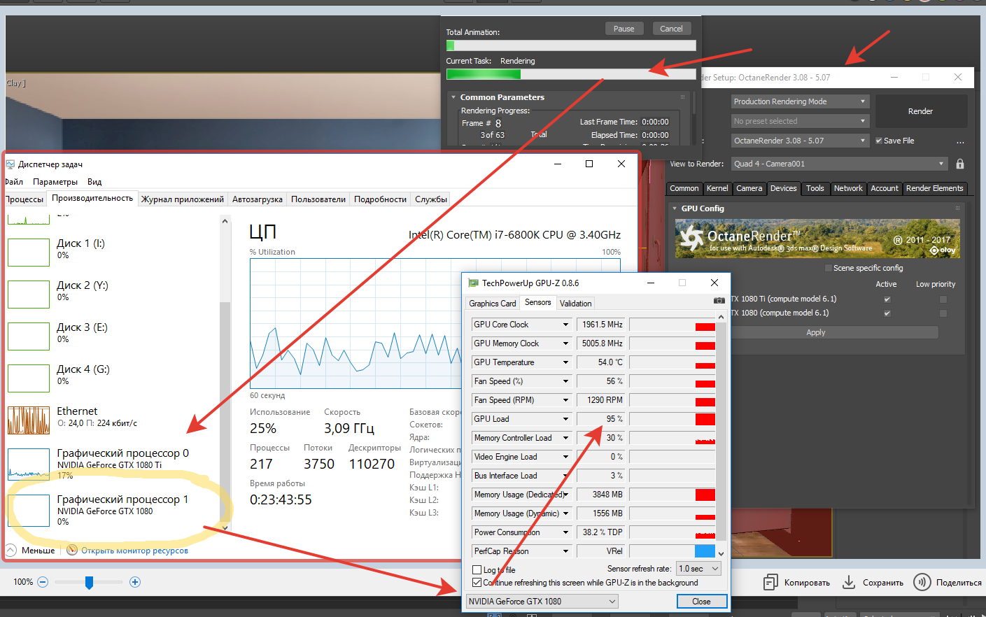

GPU-z writes that all graphics cards are involved and Windows Manager shows nonsense

Goldisart wrote:GPU-z writes that all graphics cards are involved and Windows Manager shows nonsense
Hi Goldisart
GPU-z doesn't lie,
Regards
Paride
