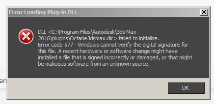

Am I only who have this problem? Windows 7 SP1
paride4331
Posts: 3972
medvejo wrote:Am I only who have this problem? Windows 7 SP1
Hi medvejo,
never seen before; did you try to uninstall e reinstall Octane plugin?
Regards
Paride

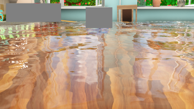

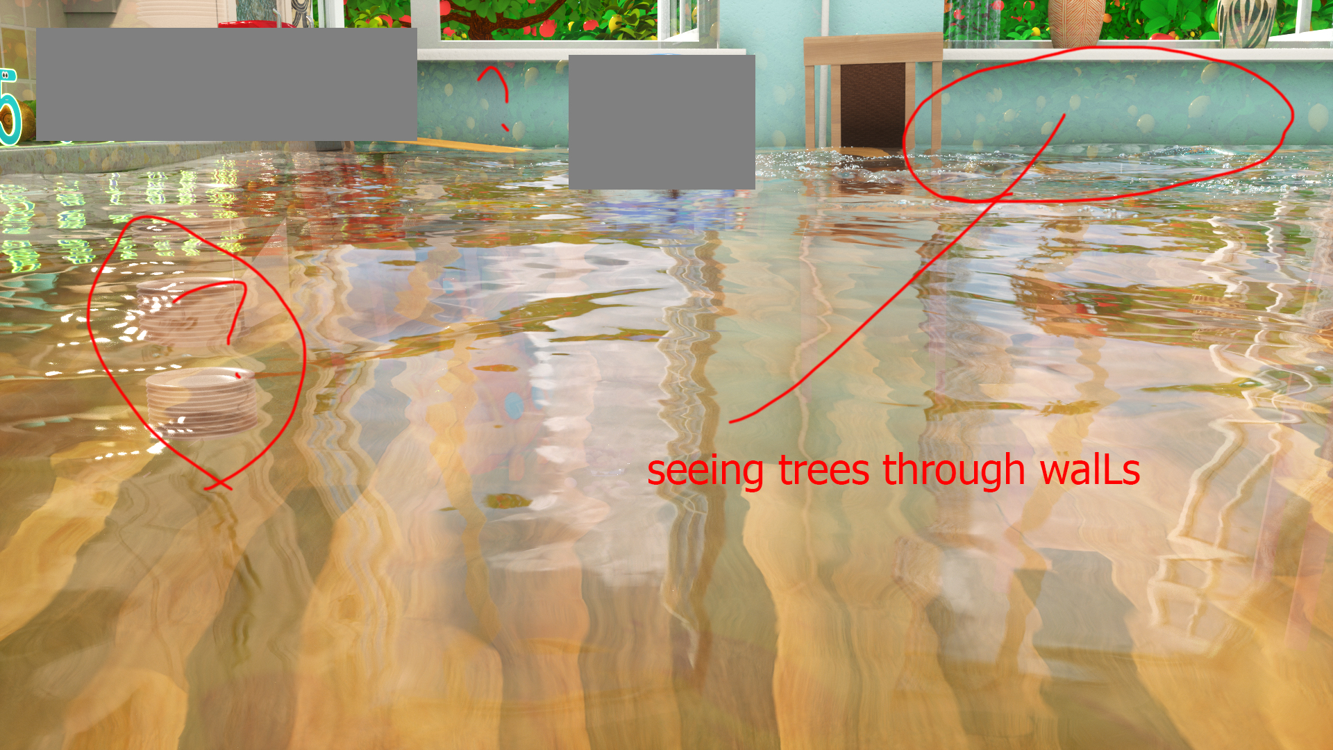

why does octane will make walls half transparent sometimes and render objects behind them. This bug appears sometimes. is it network rendering related.
Our plugins and octane render are digitally signed, witch means it's safe to install and use.
This should not affect the installation or usage of our software, but there might be some issues in some cases, that should be easy to fix.For example, windows defender or other anti virus may not recognize our certificate as 'trusted'
You may need to Install a certificate manually.
To check if our certificate is recognized by Windows, or to install it, you can right click on the installer file (eg: OctaneRender_for_3ds_Max_3.08-RC1_-_5.02.exe),
and open the tab 'Digital Signatures'. You should see "OTOY, Inc." as Name of signer.
Click on the Details button, (it should display 'This digital signature is OK.')
The 'View Certificate' allows you to install this certificate manually.
I hope this will fix your problem.
