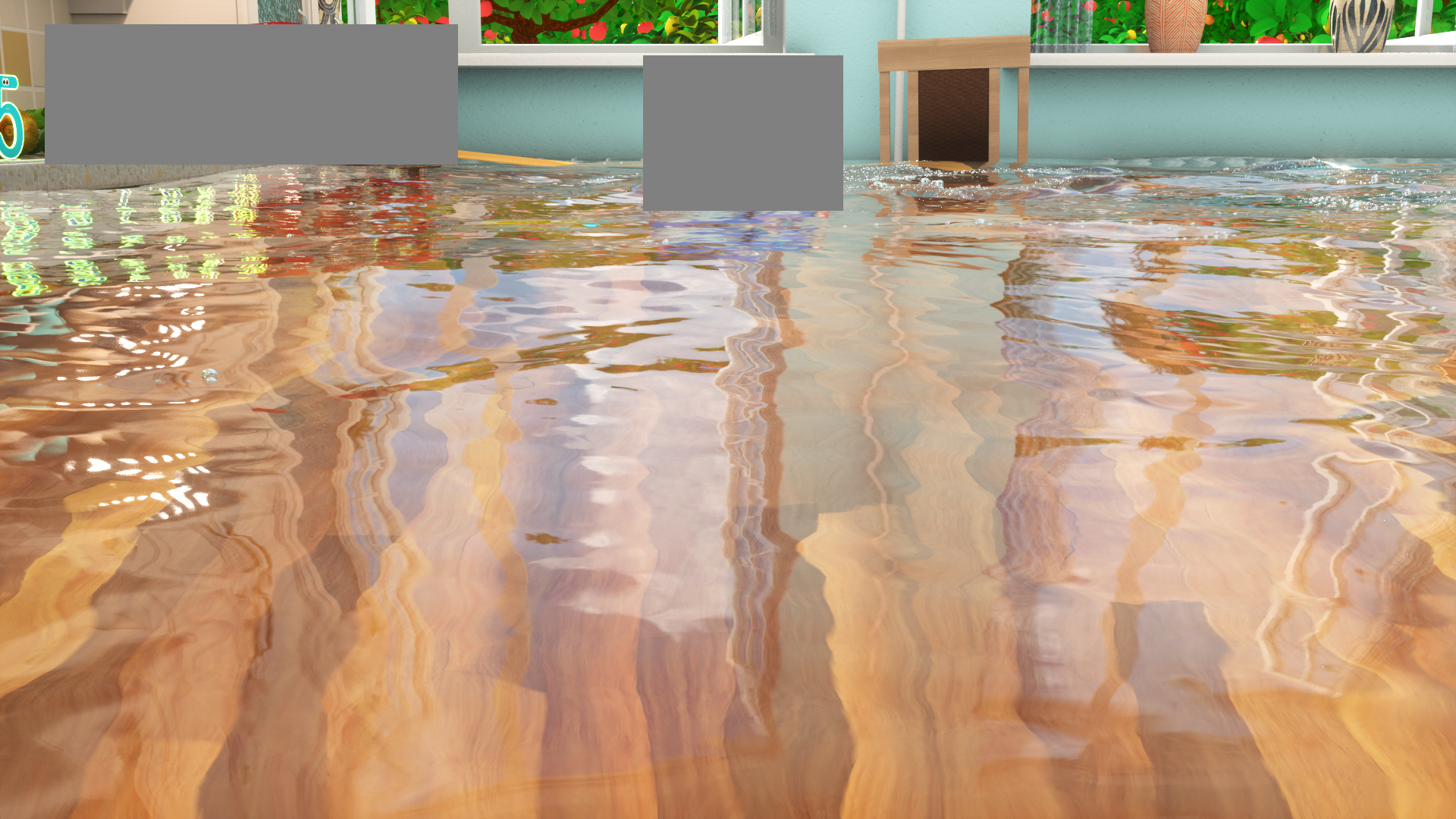

Also, you can try: in the Octane Global Settings, main tab, the 'Fix invalid material Normal' checkbox should fix this when loading scenes ..mbetke wrote:@HHBomb: What if you set the Normal not "none" and not to 0.0. It looks like an old bug from 3.07 where it displays like this.
