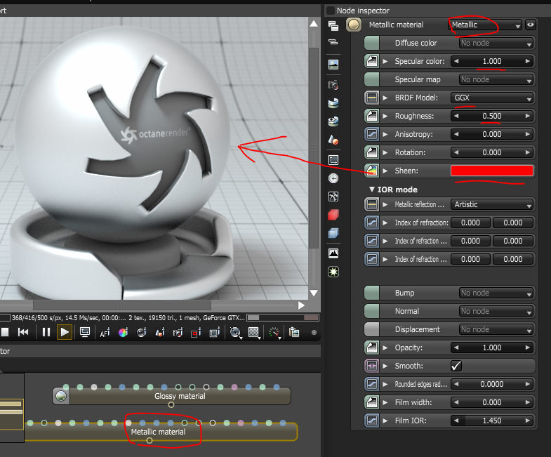

Here is a metallic material that is 100% reflective. No sheen can be seen (you explained this is intentional)wallace wrote:I am not exactly sure what you meant here. But basically the reflection from sheen is a cosine lobe oriented towards the direction that is 90 degrees from the viewing angle, and it peaks at this grazing angle. The roughness parameter controls how spread out the lobe is, just like your specular BRDF model, it can look really diffuse when you have high roughness, and you can have really sharp sheen like satin cloth for low roughness.funk wrote:Can someone explain what's going on with sheen?
Why does it draw over reflections on the glossy material, but only draws on the diffuse part of the metallic material?
Here is a glossy material, made 100% reflective. The sheen seems to tint the reflection.
Here is the OCS
No reason. I was just curious why it wasnt part of the diffuse material too. In fact I wish we just had a single material that combined everything.wallace wrote:Is there any reason why you cannot achieve this effect with the metallic node and glossy node? You can decrease the glossiness and increase sheen.funk wrote: Which leads to another question... Why dont we have sheen on the diffuse material? This would be nice for velvet/fabrics

Yes we know — you're not the first one to make this point.funk wrote:In fact I wish we just had a single material that combined everything.
In the meantime we can try to approximate some common cases with node graphs. Does this work for a metallic + diffuse with dielectric mix? Roeland
I only had a quick look, but yes this seems quite close. The only thing I noticed is you have a fixed IOR (1.45) on the glossy mat.roeland wrote:I can confirm there's an issue with dispersion. This will be fixed in the next release.
In general I think its ok, but if people are using actual specular maps from other apps, then it wont match. Disney remap specular 0-1 to IOR 1.0 - 1.8. Specular 0.5 (the default) = IOR 1.5
EDIT: Its discussed on pg 15 of this pdf https://disney-animation.s3.amazonaws.c ... tes_v2.pdf

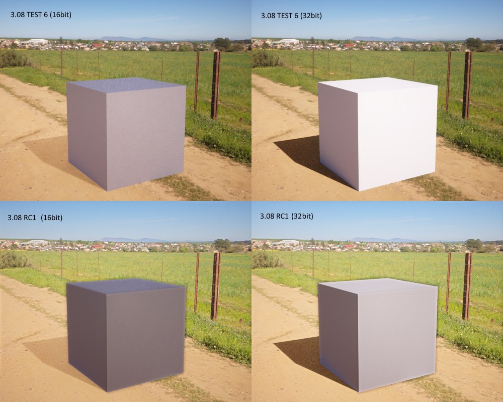

There is still some weird issue (values clipping / saturation ?) with environment HDRI with high dynamic range
( https://hdrihaven.com/hdri/?h=flower_road ) Moreover, the result differs in 3.08 RC1 version

The "halos" around the cube are an issue in the PMC kernel we are currently trying to fix.andw wrote:There is still some weird issue (values clipping / saturation ?) with environment HDRI with high dynamic range
Unfortunately, the archive didn't contain the HDR image you are using. Could you send it to me please? Thanks.
