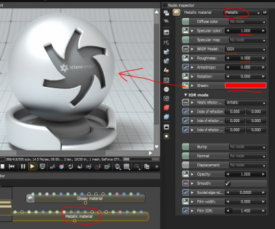

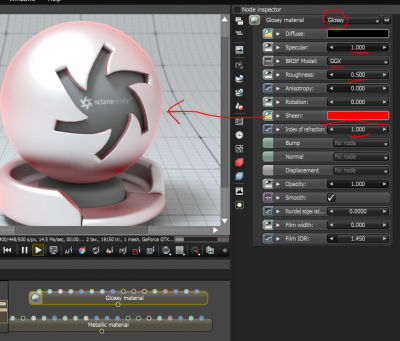

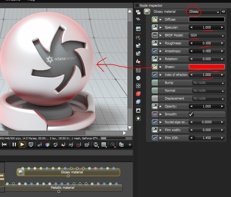

funk wrote:Can someone explain what's going on with sheen?
Why does it draw over reflections on the glossy material, but only draws on the diffuse part of the metallic material?
I am not exactly sure what you meant here. But basically the reflection from sheen is a cosine lobe oriented towards the direction that is 90 degrees from the viewing angle, and it peaks at this grazing angle. The roughness parameter controls how spread out the lobe is, just like your specular BRDF model, it can look really diffuse when you have high roughness, and you can have really sharp sheen like satin cloth for low roughness.
Here is a metallic material that is 100% reflective. No sheen can be seen (you explained this is intentional)
Here is a glossy material, made 100% reflective. The sheen seems to tint the reflection.

wallace wrote:
funk wrote: Which leads to another question... Why dont we have sheen on the diffuse material? This would be nice for velvet/fabrics
Is there any reason why you cannot achieve this effect with the metallic node and glossy node? You can decrease the glossiness and increase sheen.
No reason. I was just curious why it wasnt part of the diffuse material too. In fact I wish we just had a single material that combined everything.
