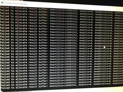

i found out that i get a lod of cuda errors in Cinema4D with octane and Net Render if i use 8K materials.
If i use 6k material i dont get any Cuda errors...
I use octane 4.01.1 Cinema 4d R19 with V4.01.1 R2 and nvidia Driver 417.35.
I dont get any Cuda Errors on my Main Computer only on my render Rig PC with 10x 1080tis

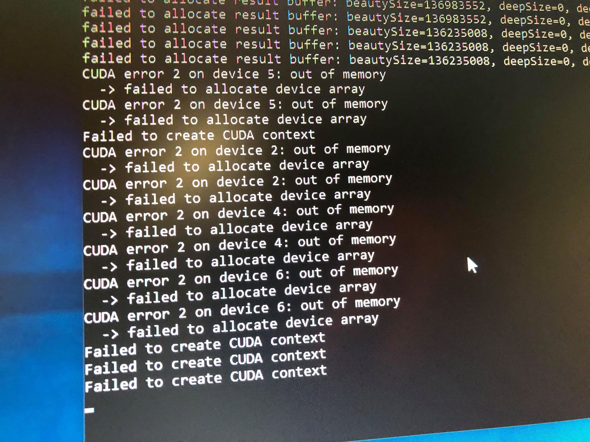

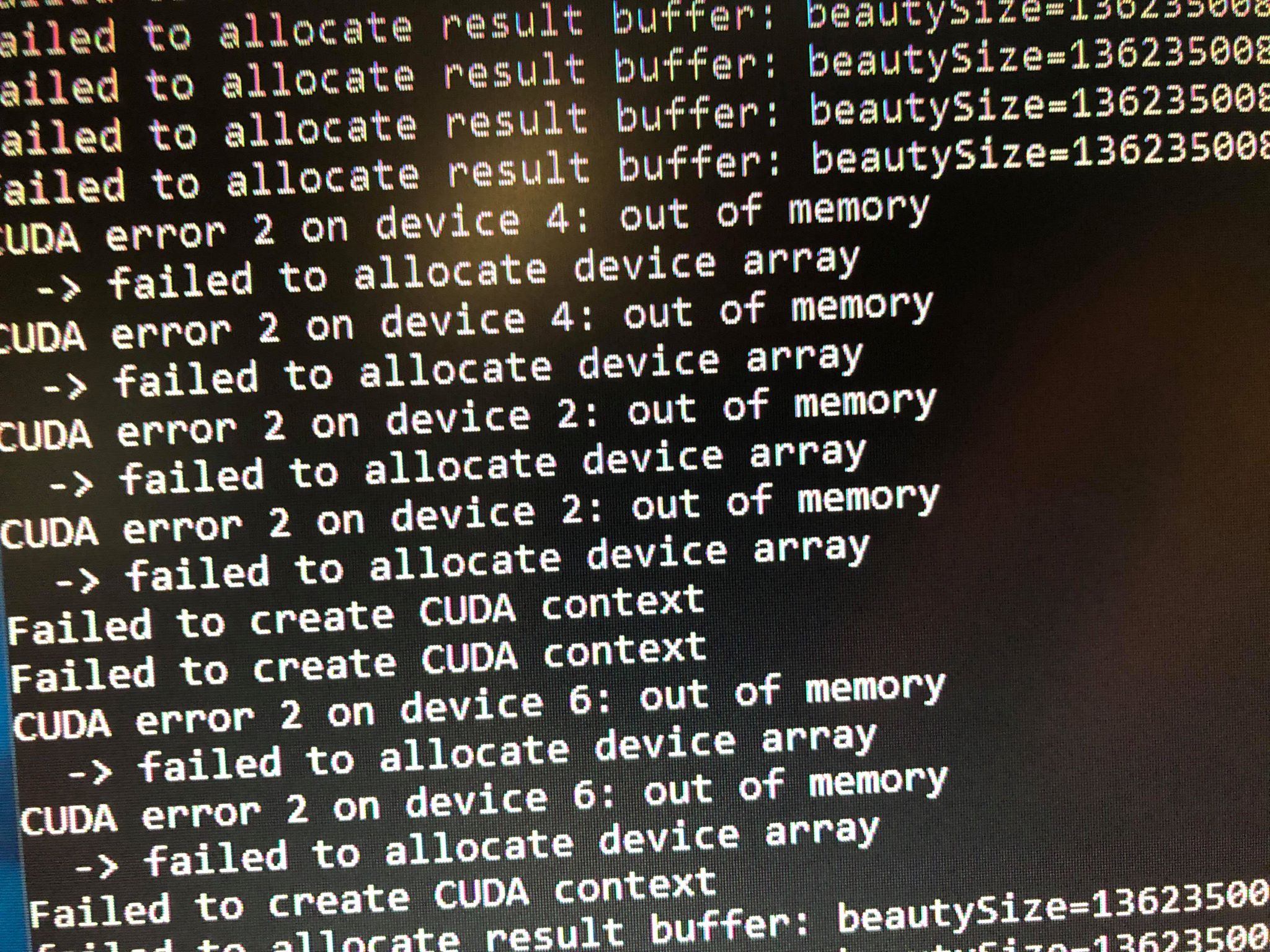

we have this error when we use almost all vram. It seems that octane out of core gives us a lot of this errors when we are low on vram
