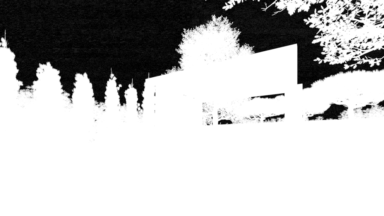

Dear Otoy team,
I don't know if this is the right place to post my discovery, or even if I really found a bug in the latest release, but I can't find other topic talking about this issue.
The enclosed layer mask was rendered in 3.07 T6. As the corresponding scene has been made in T6 I couldn't try in 3.06, but I tried to render another scene made in 3.06 which worked in 3.07T6 and it ended up with the same error.
Is this a bug or I did something wrong?

abstrax
Posts: 5516
deadakos wrote:Dear Otoy team,
Looks certainly like a bug, but I couldn't reproduce it in a simple test scene. Could you send a scene showing the problem? Thanks.

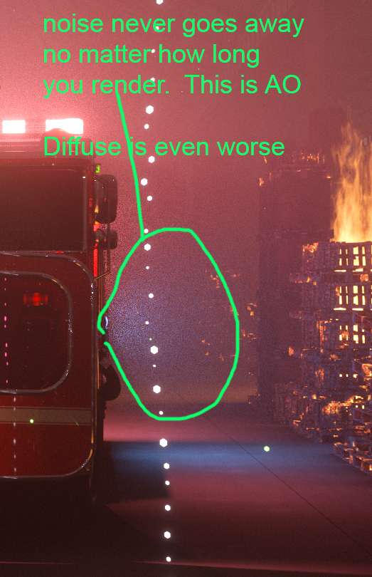

coilbook
Posts: 3174
what about noise from lights when using volume medium in the medium tab of the sun. Will this be fixed? Basically dark environments, fogs and lights and it is just a noisy mess. Why can CPU rednerers render it clean and octane still struggles with volume medium and lights
