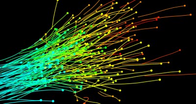

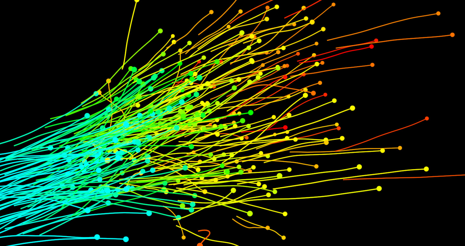

InstanceColor is not hairs, but geometries. How do you make a setup in default renderer for that?
Here's xp forum's example setup for trail colors using standard render from Lothar.
trailage.c4d.zip
(36.04 KiB) Downloaded 363 times
Posts: 16068
Location: Türkiye
trailage.c4d.zip
In the link i sent there's some example scenes for this. Trails are simply splines and we use them as hairs in renderer with some materials+texture for coloring. Colors are comes from uvmapping mapped at roots. And need "w-coordinate" for extra gradient across hairs.

aoktar wrote:
trailage.c4d.zip
Ahmet, yes.
But currently the trail shading in octane is "static". it doesnt take into account specific dynamic attributes like age or speed.
simple example: lest say i want trails that moves fast to be red...and trails that moves slow to be blue. i cant seem to find a way to currently do it with octane
The reason we ask is because u already achieved that effect with particles! :) it would be great to have it on trails too. and it would close a lot of the gaps still remaining with rendering particles\trails in C4D standard or Cycles4D ;)

I did some testing, and was able to setup the w-coordinate to shade trails with a gradient no problem, but if you use the xparticle color instance as the source of the trail gradient it only picks up the first color in the chain.
Ahmet, I understand it might not be possible, but x-particle users are hoping for a way for the trails to have a shader where vertex colors are inherited from the color properties of particles that lead each trail.
