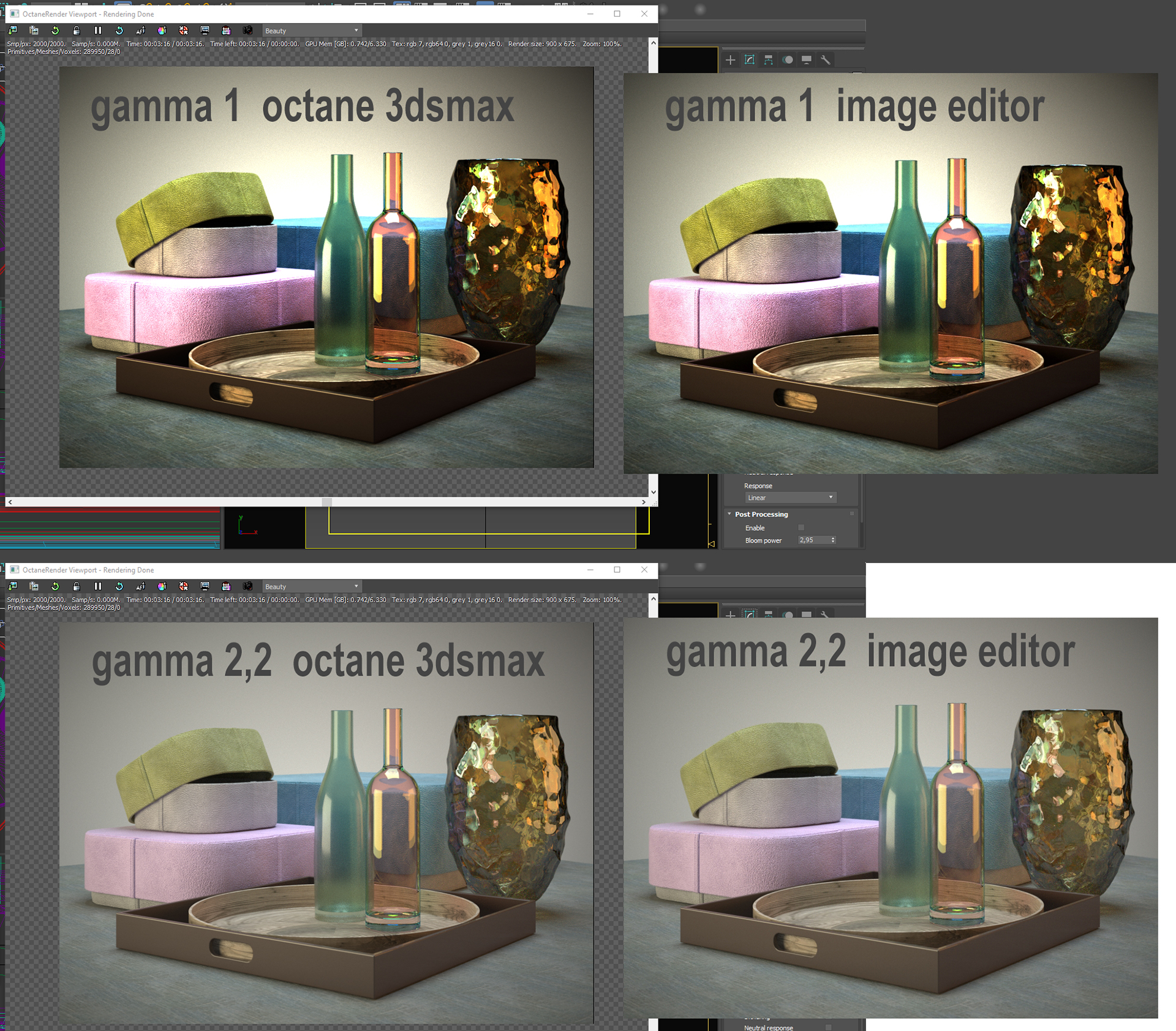

About Gamma I can not understand your issue, it seems all right, what do you find issue gamma?

It all looks fine on all viweports, but when I save image turns up darker..
Try saving it as .jpg see if there's a difference

Let me know about your gamma issue.

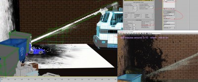

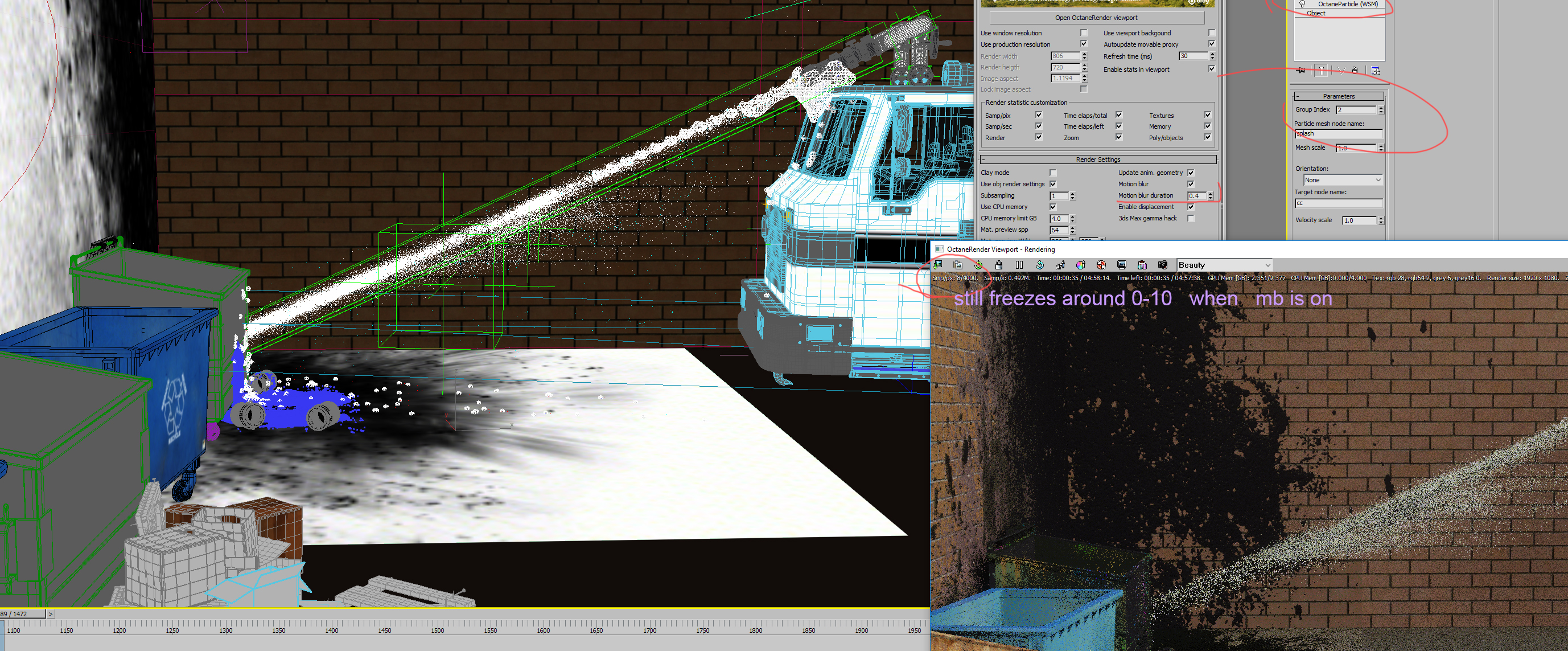

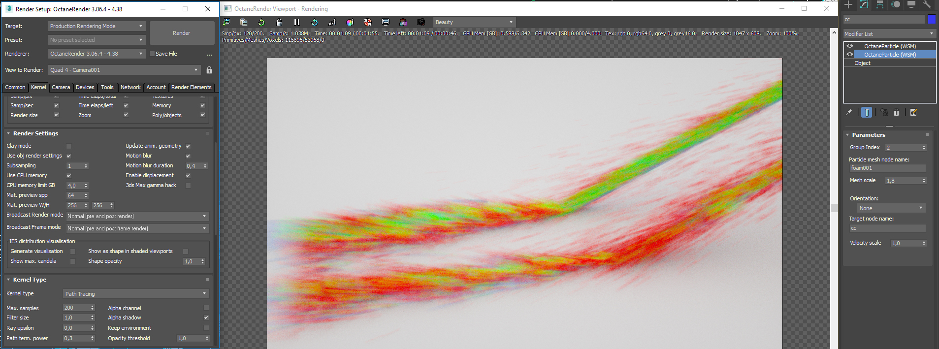

octane viewport still freezes at 1 when foam and splash are used with mb thanks
paride4331
Posts: 3989
Hi coilbook,
No MB issues I found; Could you kindly share a test scene with your issue?
Perhaps it depends on how group indexes are configured; In my case, MB seems to work.
Regards
Paride
coilbook
Posts: 3168
Hi Paride
I will.

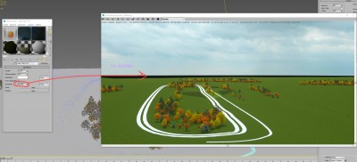

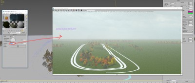

there is a problem with fog. It seems like it is too weak almost no fog or too strong and nothing in between. Volume radius is correct 10000 like the whole scene Any way to have more precise fog even changing by 0.0001 makes it from nothing to too much
