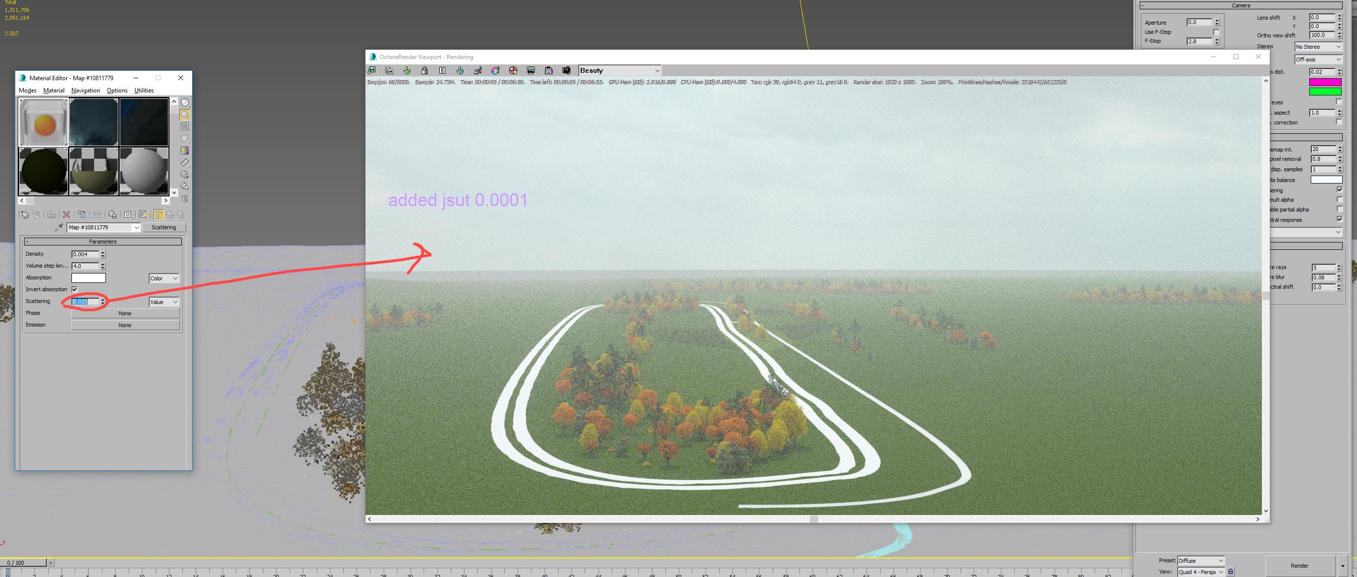

Hi coilbook,
Do you use the point as decimal separator instead of the comma?
Regards
Paride
