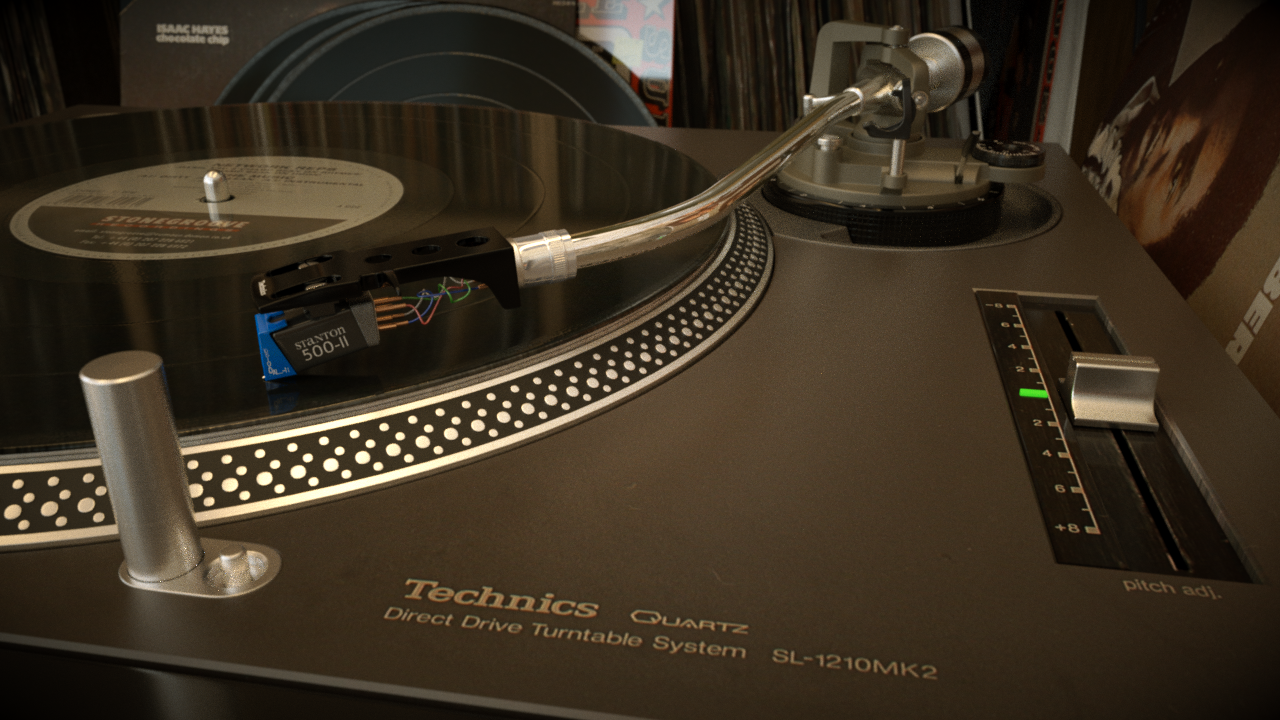

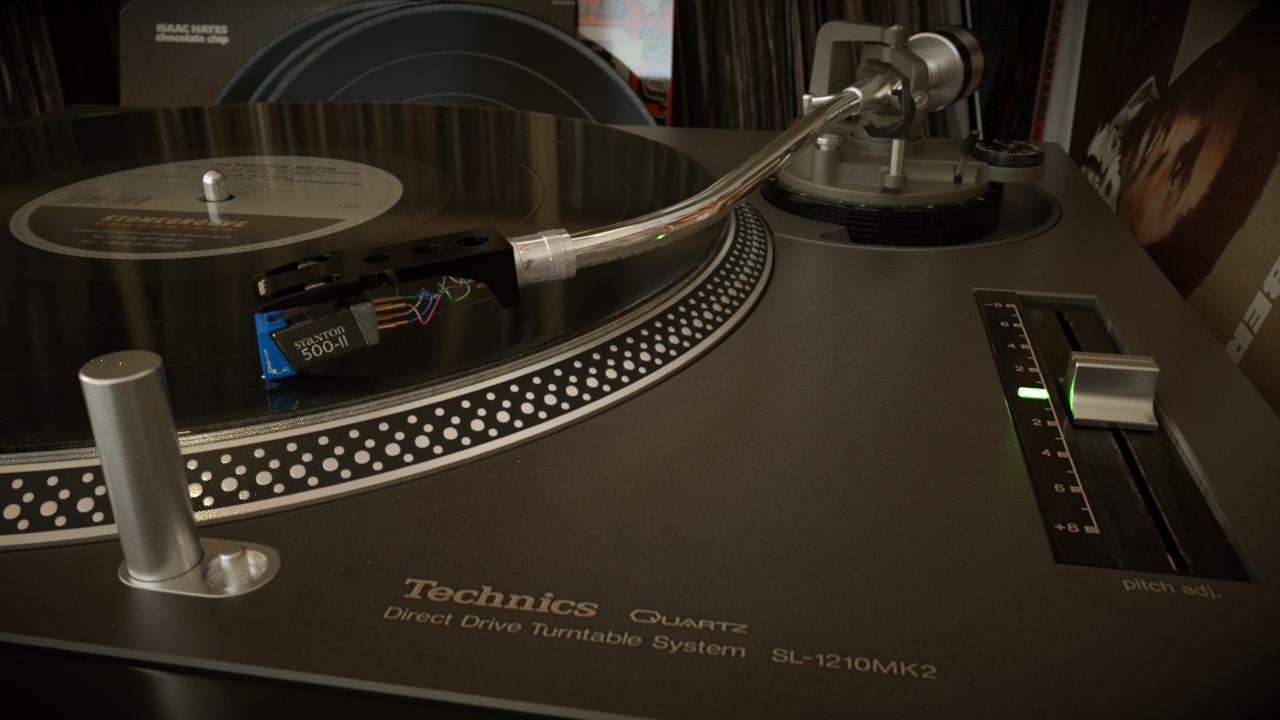

lots of hotpixels
-22min pathtracing octane2.45:
almost no hotpixels
-8min pathtracing octane2.44:
..may depend on the new features.
what can i change to make it render faster again wo hotpixels?
edit: i see that this comparison is a lil unfair due to the new features available. i need to do some tweakings in 2.45 to achieve the same visual result and maybe compare rendertime/hotpixels then again..

dave62 wrote:lots of hotpixels
almost no hotpixels
It could be the different brightnesses of the lights. The LED on the right is now very bright, because the brightness is now independ of the size, while it was dependent on the size in the past. Could you try to tweak the lights to get a similar lighting behaviour as in beta 2.44? If the noise stays like that, we might have introduced a problem.
almost no hotpixels
I don't think it's a bug/change, it's probably related to the changes in parameters to area lights,
you need to reconfigure them to get the same result, then compare.
Apart from the different area light watt/efficiency controls, we did'nt make other changes that would create more fireflies,
so try to replicate the original setup as good as possible.
I'm not %100 sure though, could be an issue that was introduced with the modifications to area lights,
i think we need more time/testing to make sure.
If anyone else experiences this, please report here :)
