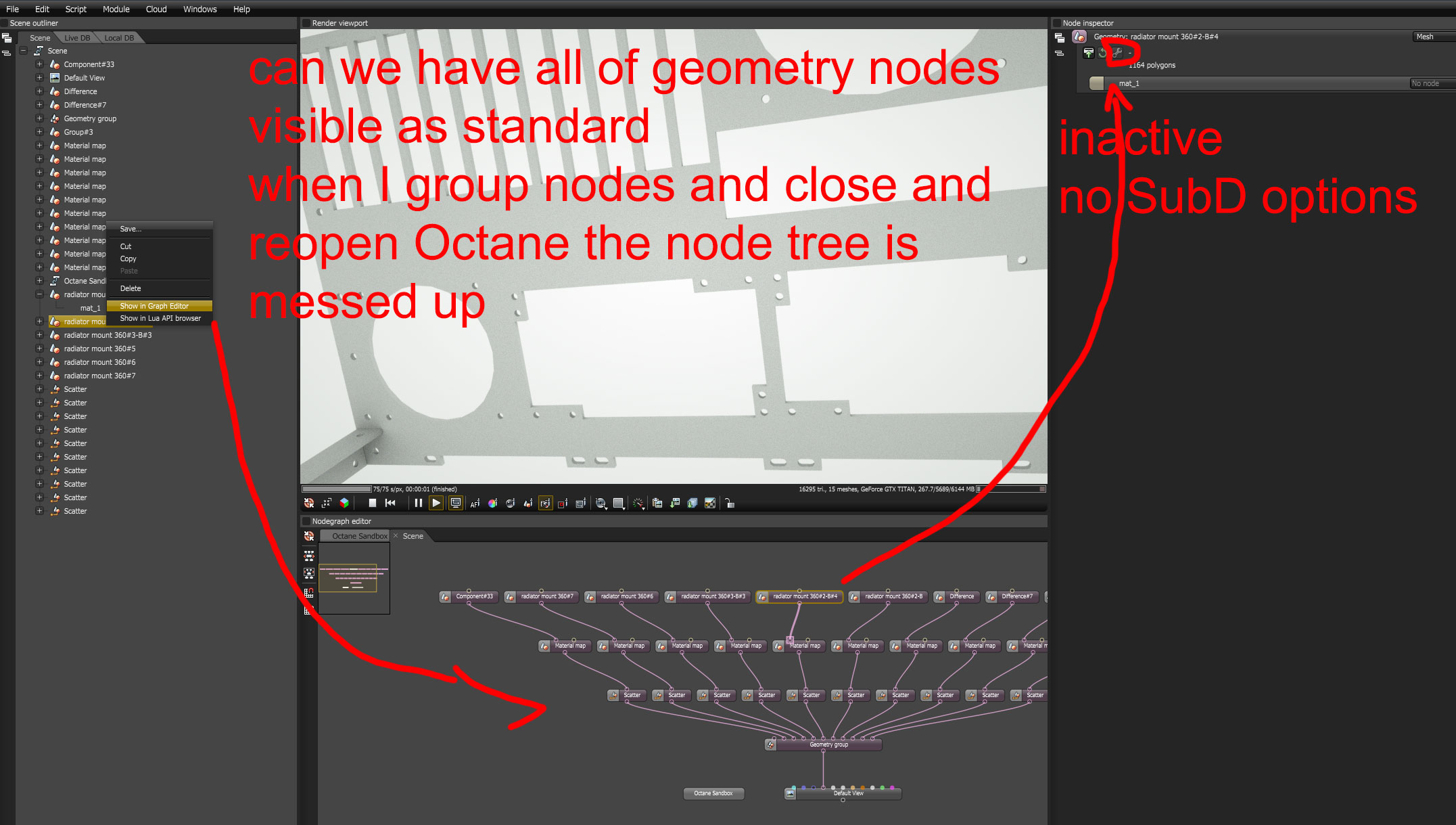

Q: how can I use the standalone feature for geometry subD? I just found the way to get all geometry nodes displayed in the node editor, but still options for SubD are not active. And grouping nodes is not permanent - a node tree is broken after reopening Octane. Please fix it asap.
