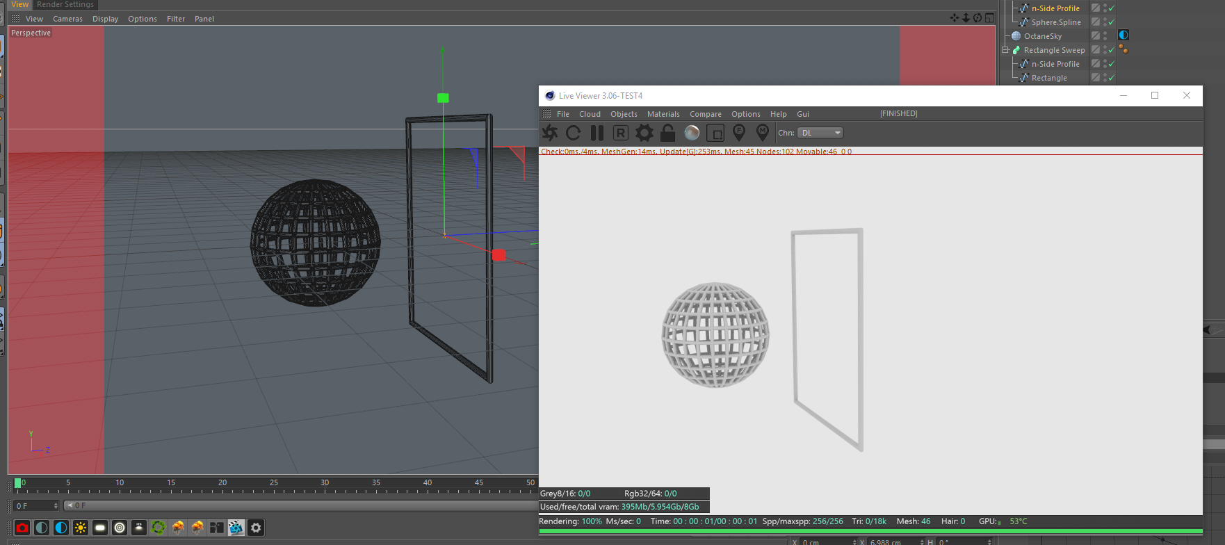

milo_dude wrote:Building geometry by spline using Sweep. When geometry update starts plugin is crashed.
Same trouble in test3 and 4.
3.05 works fine.
Yes it's crashing the renderer. We'll investigate it.
Thank you so much! It will be great!
no crash. and animation ok

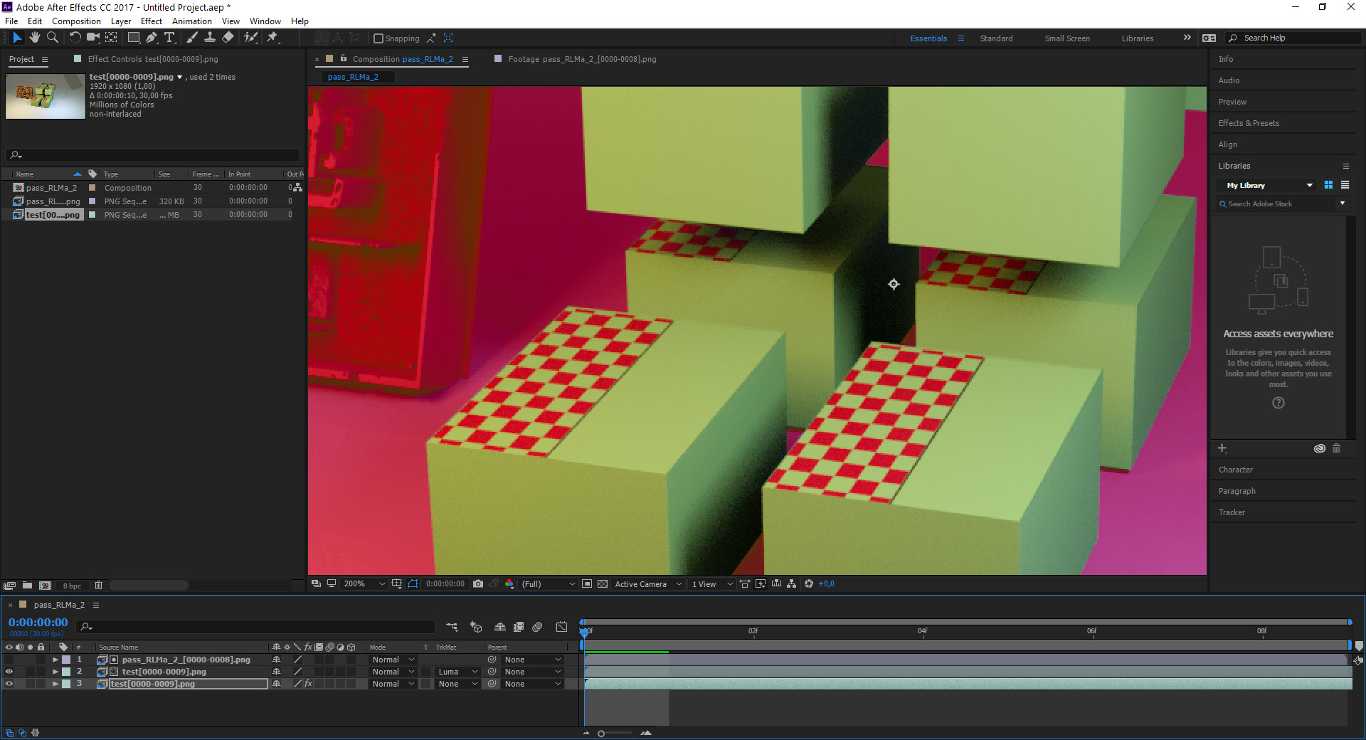

Ahmet, render layer mask is broken, just not working in this version (generating blank frames). Are you aware of that?

Yambo wrote:Ahmet, render layer mask is broken, just not working in this version (generating blank frames). Are you aware of that?
Y
with png? I think it's about my changes to drop the using of embedded alphas with png.
Y
Yap, basically if i'm loading some layer mask to after effects i can see only a full alpha.
Is there something i can do to workaround it? or just wait to the next version?

Yambo wrote:
Y
Thanks!
Y
disable alpha and use rgb colors for matte

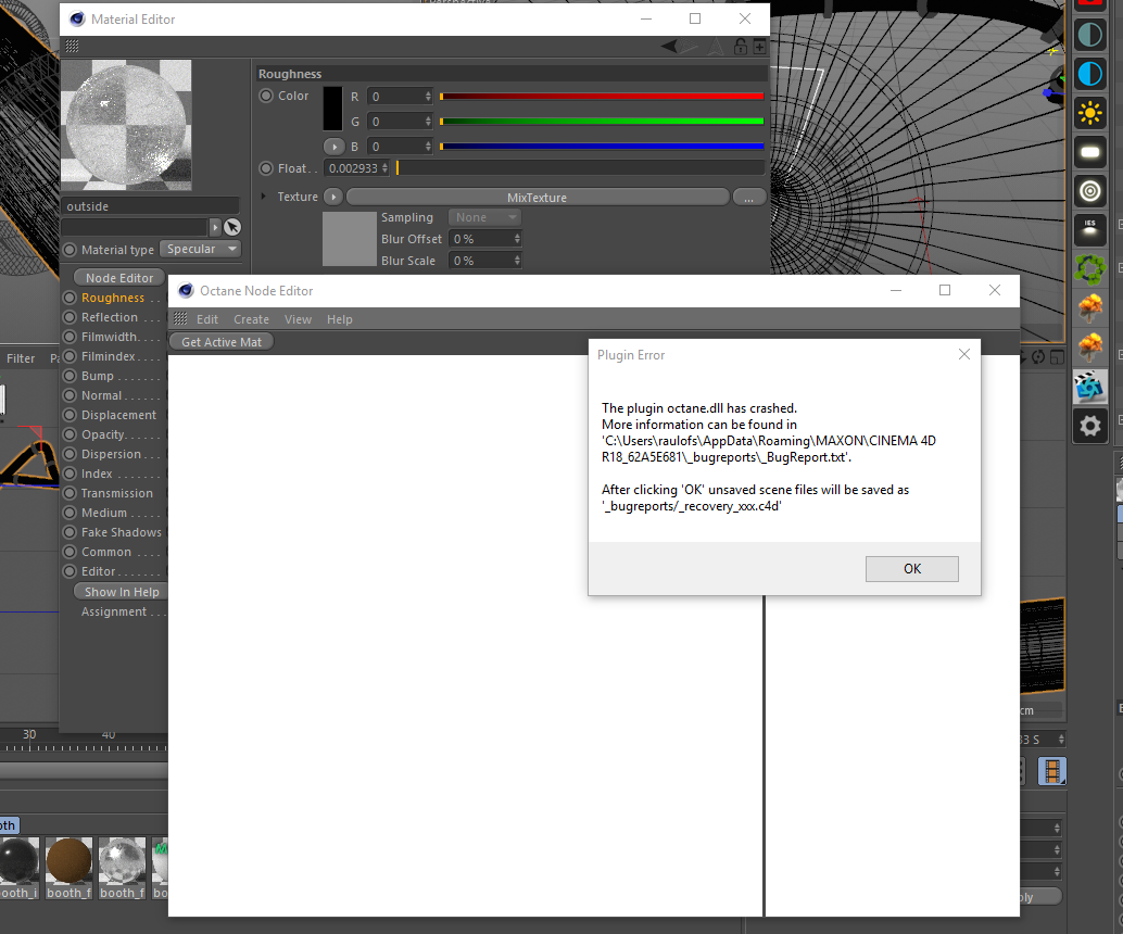

Hi, Ahmet.
Thank you very much for your great effort to integrate this fabulous engine to c4d
I have some problems with test-4
When I open the node editor sometimes, it does not allow connecting one node to another and it make to freeze it, also randomly crash the plugin when I open other materials in the node editor :cry:
I leave the sample.
_BugReport.txt
(210.3 KiB) Downloaded 305 times

raulofs wrote:Hi, Ahmet.
I leave the sample.
I never use like that and didn't notified that. Yes i could reproduce this bug. Thanks!
